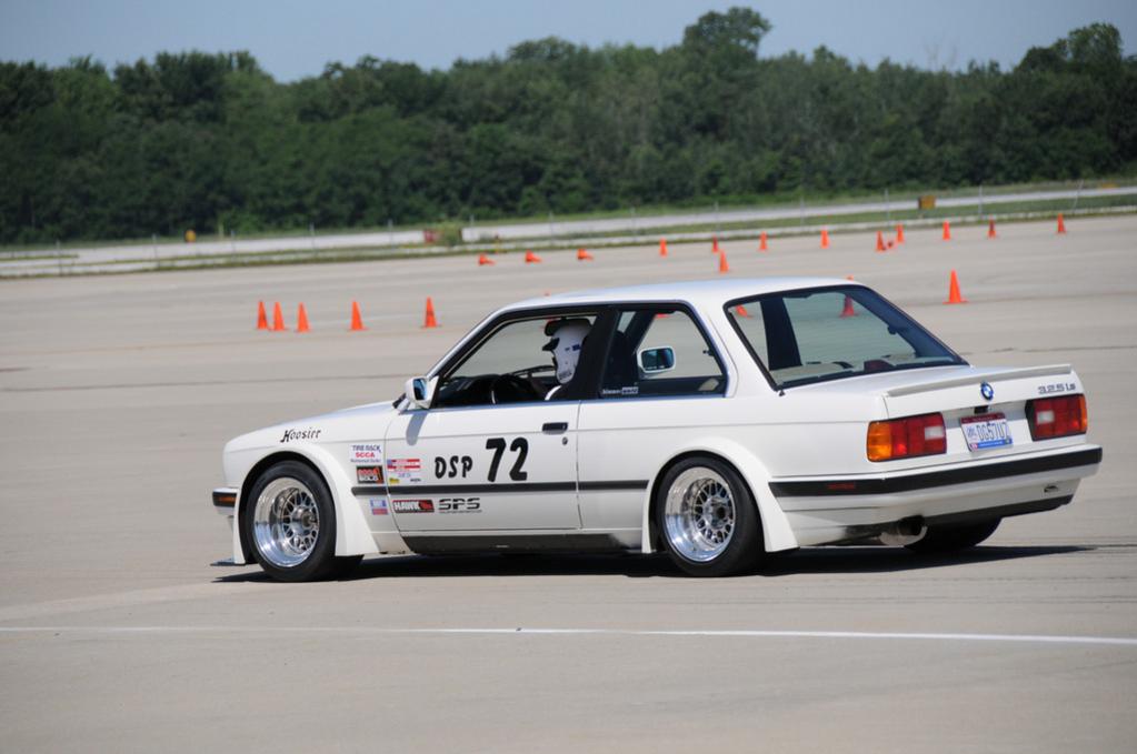

    You would have to run BIG spacers with those. Spacers will be about $150 per end so by the time you add in $300 for spacers you aren't saving that much money. FWIW regardless of what some say you aren't giving up that much performance by going with only a 9" wheel either....
    Work Equip 03's are available in a 15x10 and those were around $400/per.
    Beyond that the best deals I've found were REAL racing wheel. quoted at $387/each in 15x10 5" backspace.
    Kiezer around the same price for the same wheel.....They can build 15x10.5's also Real can't.
    Those are your best options. There is Kodiak also but they are close to $600.
    Your backspace magic number is 5"
    CCW quoted me at 2200 a set for 18x10's. He said he didn't want to do 4x100 wheels but would......
    Real wheels at 15.5lb
    Keizer at 12lbs.

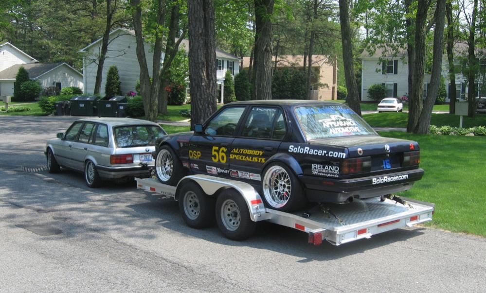

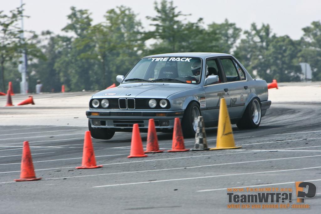

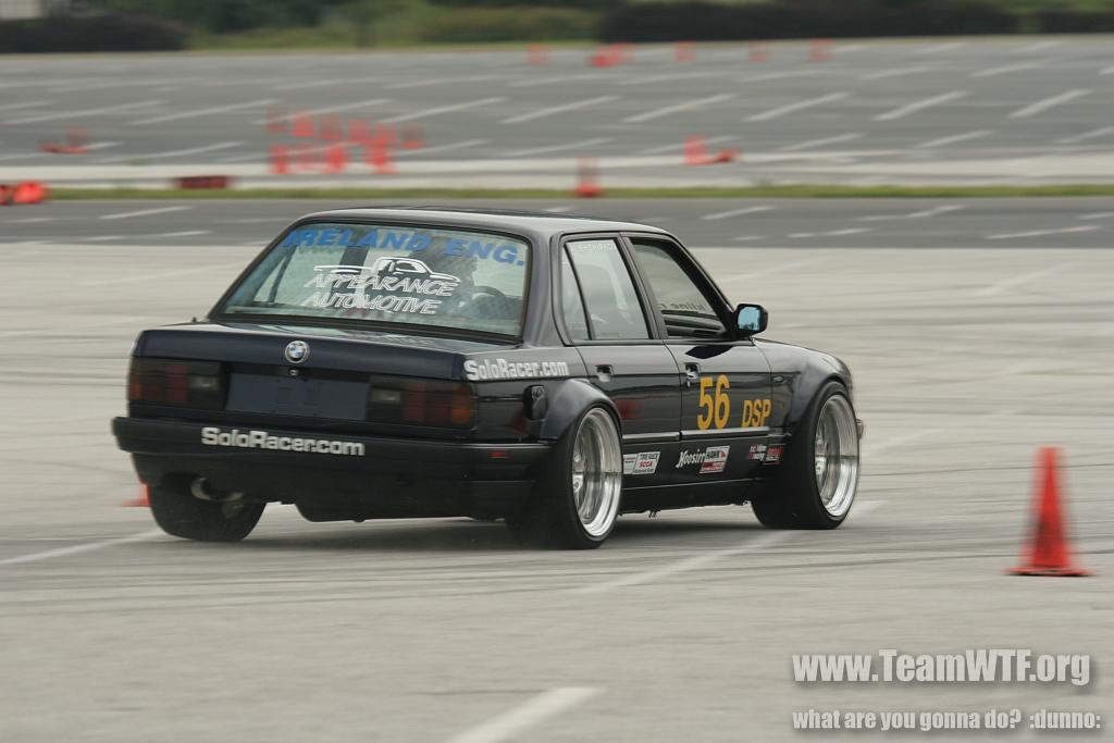

      See pictures above. It's obvios which car has the 18's.

        Wow that black 4dr is sexy. 18s just look huge on an e30. I've even thought about turning the front and rear rotors down to 250mm and running Alcon brake calipers then putting a 13x10 with the new 255-40-13 Hoisers. I prolly wouldn't even need body mods. Also to take the advantage of a smaller lighter wheel and tire?
