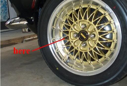

Because of the intricate mesh pattern the electro magnetically charged metal has problems attracting the powder in the tight corners and in the mesh. Because some parts of the metal are so close together (see picture below) they contradict each other and it may not work.
He said in the cases he's had before, some have come out great, perfect, and others have failed to seal in the grooves, sometimes two might work, two might not.. so there is a risk.
Here is a picture showing where exactly he said there might be a problem:
SO is there anyone that has had experience with this type of thing? I don't mean podercoating just any wheel, but in particular mesh wheels or other complicated patterns? How did they turn out?
My other option is to paint them myself, I am confident I can get an as good or better finish, but it will certainly not be as resistant to chipping, or brake dust stains. And I really don't want to have to paint these again for a long time..
