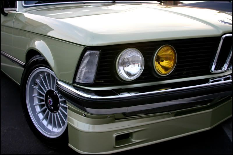

      i like the dish these have ...im pretty sure this guy has them

        That is sexy if its the same wheel... i guess youd just have to check offset

                  13mm is perfect offset on an e30.
                  These are 15x7 et12 and just barely rolled rears on a 205 55 15
                  ...also e21 fitment.

                        I can't speak for the knockoffs, but I have the real deal 15x7 et 12 Alpinas and they fit damn well I think. Caliper clearance in the front is an issue, so I run mine with a thin spacer.
