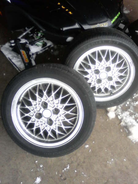

    Hey guys I have found a set of 15" BBS weaves that I want to confirm will fit an E30.
    I posted this question in the wrong section of the forum.
    From what I have read 4X100 with 35 mm offset should bolt right on.
    I found a set that were on a pontiac pursuit and the numbers on the alloys read
    BBS
    6JX15H2
    375ET35
    The ET35 is the offset correct?
    Where do I find the Bore size?
    Spacer where do I find one and should it be fitted to hub?

    You probably have to measure for the bore size. That should fit if you can find a 10mm hubcentric spacer though.

        at et35 (6 in wide) youre going to want at least a 15mm spacer. i have an et38 winter wheel set and even with the 20mm its not as far out as i want it to be.
        have to measure the hub bore size, as they tend to be different from european - domestic. e30 is 57.1mm

          For looks you are right, but to clear the inner bits you'd only need 8mm or so, maybe a little less.

            You actually need nothing to clear the inside. They're that narrow.
            But definitely at least 15mm to look good.

              i used a 15x6 et30 with no spacers no problems the whole time I used them.

                Great help guys. I am looking to fill the wheel well abit So where would I find 15MM spacers to accomplish that.? is 15mm enough?

                  If you're going to do it, go wider. 20mm minimum.

                    with my et38 rims i am:
                    15mm spacer in the front (20mm would look better)
                    20mm spacer in the back (25mm would look better)
                    25mm spacers are hard to come by, though.
