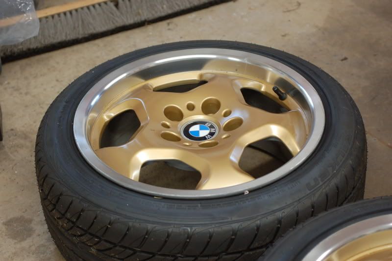

    I put my deposit for the ESM BBS RS Reps gold staggered set 16x7.5/9.0 and I'm having a hard time deciding what tire size to roll with. I was first going to do the toyo tr-1's with 205/45/16 and 225/40/16 in the rear. I also don't mind fender rolling either.
    I kinda like the stretched look, but not too stretched, I don't want the rim hanging off the fucking edges into the concrete when I take a turn somewhat hard. I am also reconsidering the sizes to, b/c I don't wanna go too undersized either and have my speedo be all off.
    (Can you get it recalibrated if you do??)
    I was thinking of 195/50/16 up front and then 225/45/16 in the back. I want an even stretch with the front and rear...I don't want the back to be more then the front or vis versa...I think you get it.

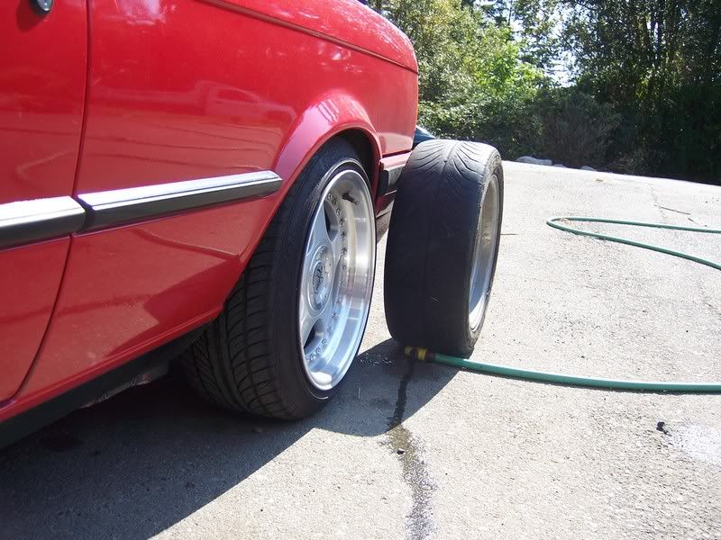

                          well, I've been thinking about the exact same dillemma for a little while now and have finally settled on falken ziex 512s 205/45/16 up front and 225/40/16 rear. The overall diameter is nearly identical. Falken is one of very few companies that make a 225/40/16.
                          I'm also looking for a mild stretch. Here's pics that have helped me decide:
                          falken 512 205/45/16 on a 16x7.5" wheel
                          falken 512 225/40/16 on a 16x9" wheel
                          The stretch is pretty equal front and rear and not too extreme.

                            thanks alot man!! the wheels look sick, how do they fit in the rear???
                            edit: noticed it wasn't your car, whats the wheel offset of those wheels?
                            89 Alpine White e30 325i
                            • Lof8
                              • Oct 2006
                              • 2827
                              yeah, those pics I posted are not mine. The pic of the rear wheel/tire is an et25. Our ESM's will stick out 15mm further.
