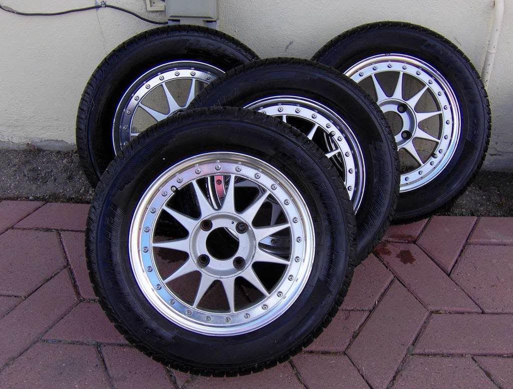

    hartge wheels for Nissan.
    So im thinking of buying these wheels but the bolt pattern is 4x114.3. I was told i can just get this adapter in order to fit properly. Will this be fine? http://adaptitusa.com/index.asp?Page...PROD&ProdID=83

    The adapters say the are 1" thick (@25mm) You need to get the et off the wheel & subtract the 25mm to see what the net offset is going to be & if that is compatible with the BMW. I have a feeling it is going to be @ 15 to 20 net.

      here is the wheel size. is the et the 38?
      Wheel size: 6JJx15" +38
      Tire Size: 205/60R15 91H M+S
        Yes. With the 25mm wide adapters those wheels will sit in a good place.
        You should look into wider lips for those wheels... 6" wide is :(
          Widening them will screw the offset up. I agree, a bottlecap-width wheel isn't too desirable.

            Well, 3 piece 15" Hartges are pretty rare - but you are trying to offset their rarity with a less than desirable 6" width & an marginal offset at et 13. Add in the cost of adapters at almost $200 & you may want to walk on these. You've got to be happy with them - it's your call.

                Do they come with center caps that cover the lug area? Id say have em redrilled and get new lips to make em nice and wide :)
                And et13 is fine. I have 15x7 et13 BBS RA's and they fit perfect. I actually have spacers in the rear.
                This is et13 15x7 with 205/55/15 tires on H&R race springs. Very very little rear fender rolling, none up front.
