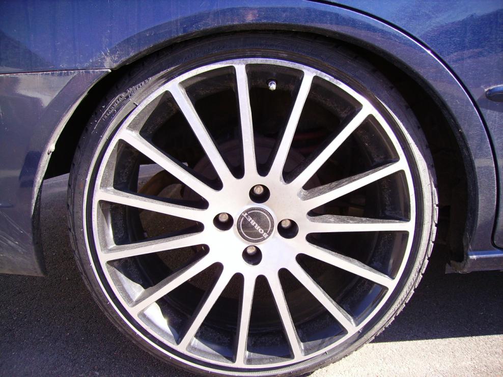

    Would these rims fit my 1990 325ic??????
    Whats up every one, just wanted to see if any knows if these rims will fit my 1990 325ic.
    The rims are borbet ls, the tire size is 215 18 35....
    I dont know the offset?? They are currently on a honda.
    They do have the hub centric ring in them,
    The guy who is selling them bought them from a guy who had them on his e30, The guy with the e30 is in the military and bought the rims over seas, (Germany I think??) and brought them back for his e30.
    Any info would help!!!

    18's are TOO BIG for a e30 IMHO
    plus it is obvious that offset is way wrong for a e30 unless you had 20mm+ spacers.
    I would keep looking for something else in the right offset and nothing larger than a 17" wheel...

      Nah I'm not thinking they will work at all. Dont try, you will be disappointed with the result.

        would need 20mm spacers, i STRONGLY recommend h&r trak spacers. and id switch to a stud kit for sure. other than that, certain 18s look good on e30s, some dont, those may not be a good set. look kinda like wagon wheels.

                    that size rim/tire is almost dead nuts the stock rolling diameter for an e30 wheel
                    that doesnt mean you should put them on, though.
