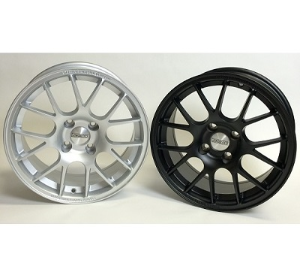

ID:	9938114 Need some advise on wheel fitment!!!
    I just got done swapping my S52 😁 ive been looking for some nice E30 wheels that would fit with no spacers, or any modifications and i came across these Wheels they are spec e30 and actually look nice
    now my question is would i be able to clear 225/50/15 without rubbing the tires i got in mind are Toyo R888R
    **No snow or extreme cold weather in my area and car will be daily driven and tracked twice a year**
    15×7 4×100 57.1
    ET25 / ET15
    Which offset should i go with ?
    Which tire size ? 225/50/15 ? 225/45/15 ? 205/50/15

    You could run 225 but it would do better on a 15x8. trm 25x8 is a proven wheel with the combo you are wanting to run

      Yea i decided to go with konig wheels they lots of 15x8 25eta options that dont weigh much and look good, do you know if i need spacers to clear or any hub adapter rings ? Stock fenders dropped on h&r sports stock brakes

        Did you end up throwing on 73 to 57 hub centrics and like a 10mm spacer? I am looking to go the same route....
