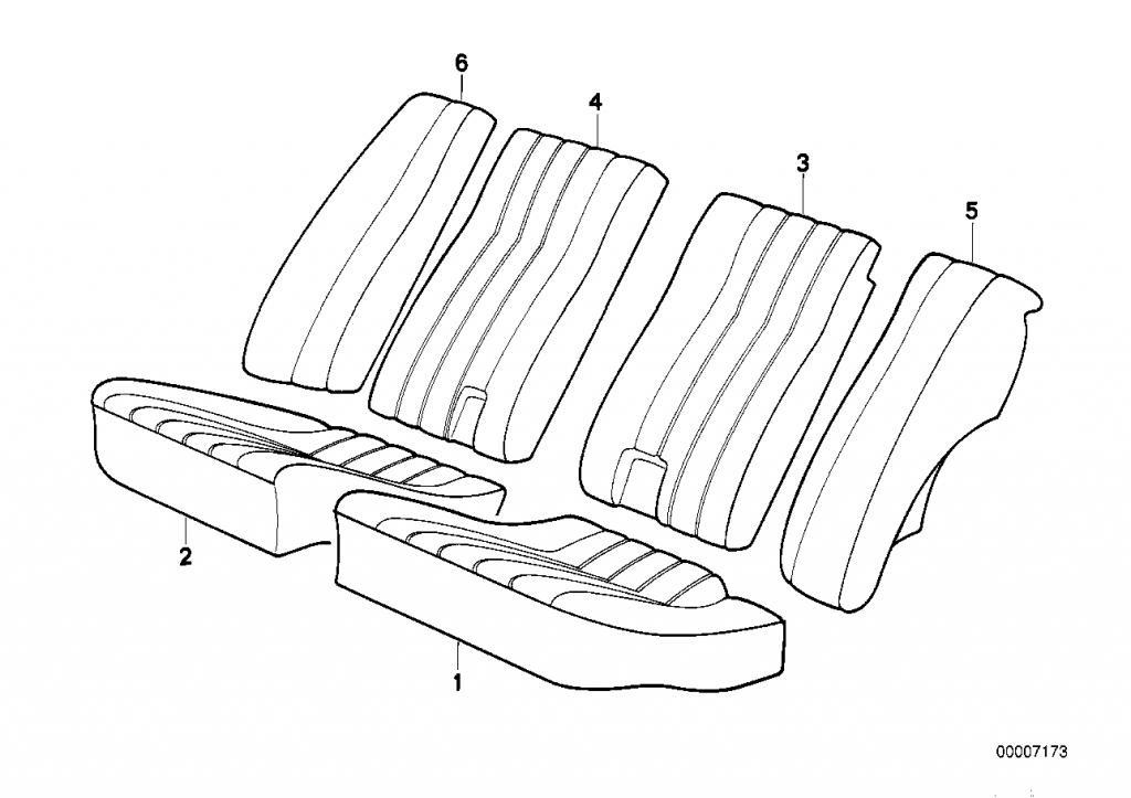

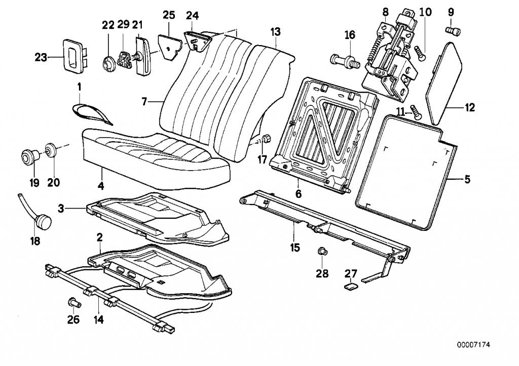

    I've pin pointed all of my squeaks and rattles to these points:
    Items 5 and 6, these bolsters squeak a lot. Haven't quite figured out a solution, when I reinstall them the squeaks go away but come back after about a week. Perhaps some felt tape wrapped around the points where they make contact with the body?
    The seat locking mechanism, number 8, where it locks onto the pin, number 16. There's quite a bit of gap in the locking mechanism, so the seat is free to move a couple of millimeters, and bounce on the pin and make a rattling sound.
