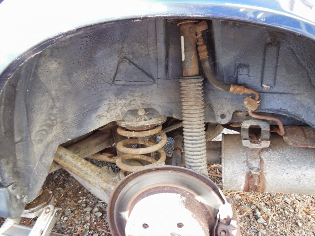

      When I first got my touring i was cleaning out the wheel well and noticed the bottom and cutout and there were lines running there so i assumed it was hard fuel lines and they ran them differently than other e30's then noticed the lines that went to the shocks were ziptied in the wheel well. I would have doubted you too till i saw that lol

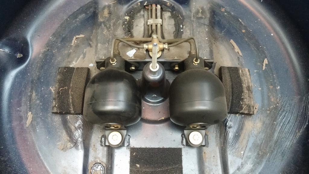

        If you're curious have some pics.
        • Shangsta
          • 1485
          Thanks for the pics. I have yet to remove the plastic cover that goes over the reservoir in the wheel well so that second pic definitely has me wondering if mine still has them(Im thinking it probably does). I am going to be doing a full suspension refresh in the rear and while it is out I will probably go ahead and try and remove the remainder of the system.
