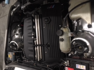

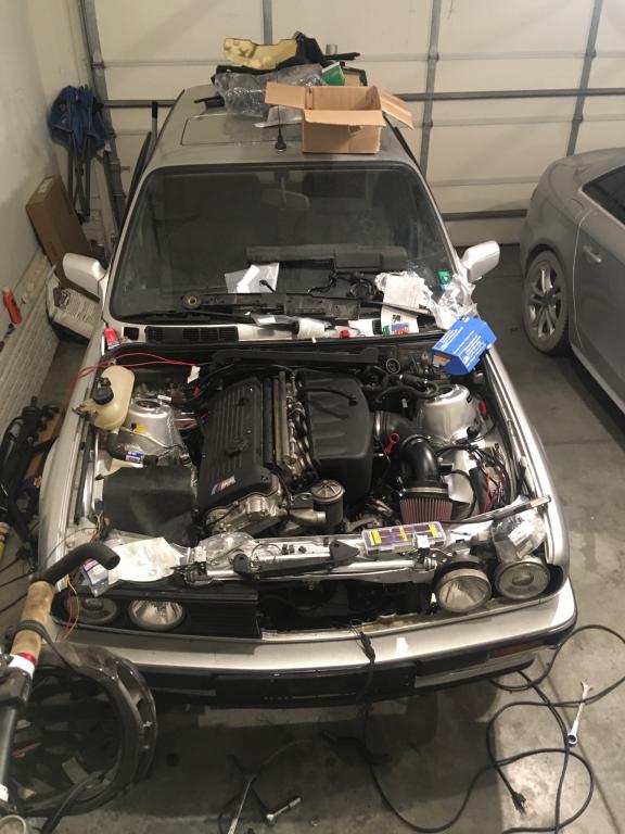

    My 318 S54 swap
    Getting close

    Hell yeah! That is gunna be one fun touring.
    Can't wait for more pics.

      That is going to be sick!
      What ECU are you using?

        Sick!
        I gotta start tearing mine down already...

          Wow! Super awesome

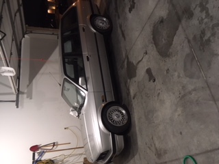

            More progress...
            Back on the ground. Interior and a few cosmetic issues left to do

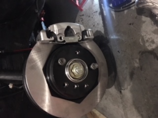

              5lug swap done
              Max front sleeves and Z4 rear hub with SRS concepts rear bracket. Running e46 328 calipers and rotors front and rear. 300mm front and 294mm rear

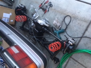

                Obviously reworked all suspension
                Koni shocks, H&R touring specific springs, new bushings, control arms, etc. Swapped a 3.64 lsd from a z3

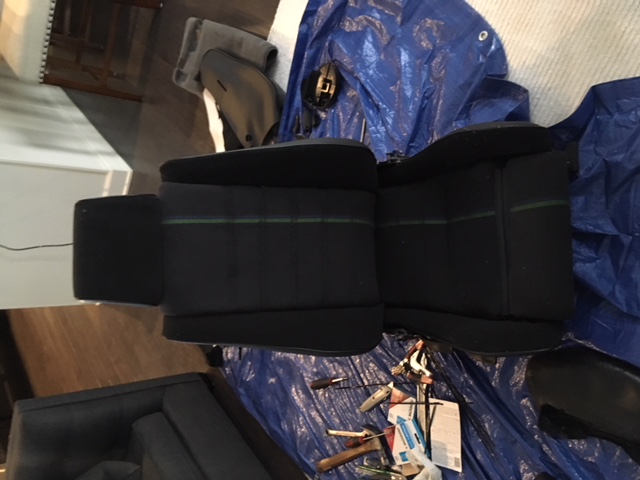

                    Alpina
                    Working on interior

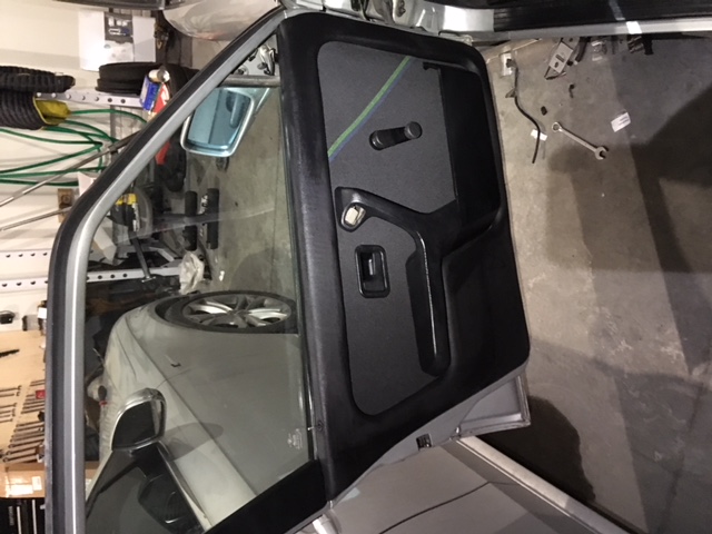

                      More
                      More alpina cloth...

                          touring specific springswaffles—wafflesnice.
