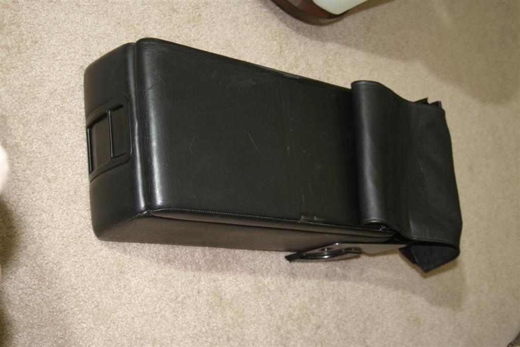

    Picked up an e32 rear console for the back seat.

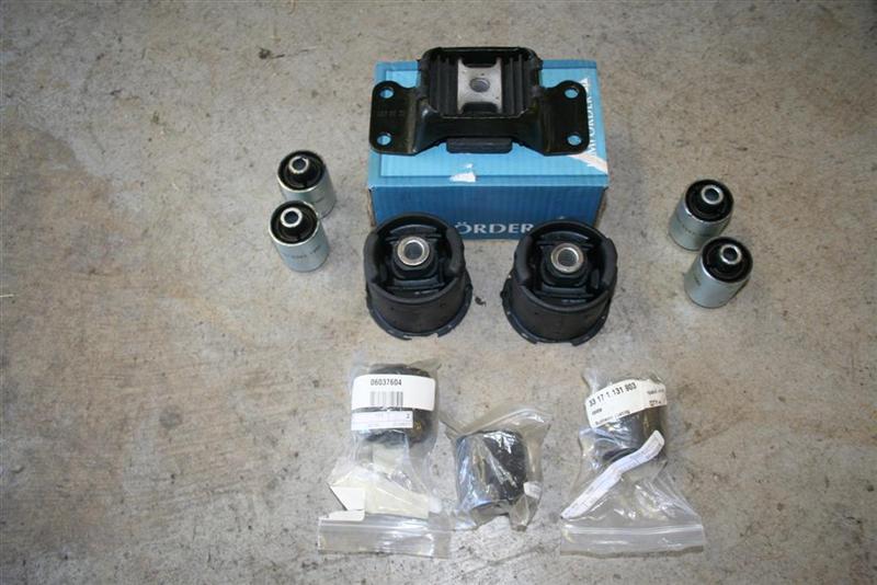

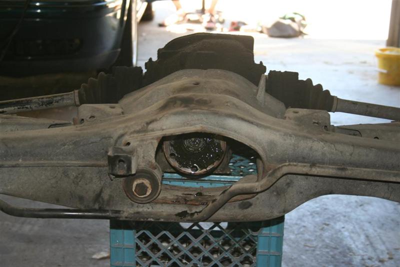

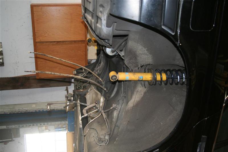

        Couple weeks ago I installed another new front end, to replace the cheesy FCP branded parts.
        Went with Lemf/Meyle HD on all parts.

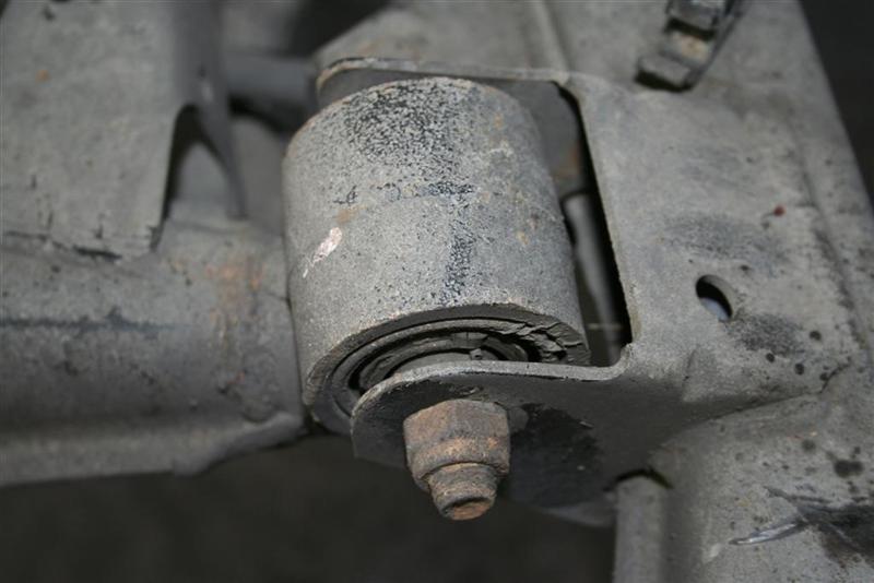

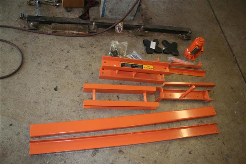

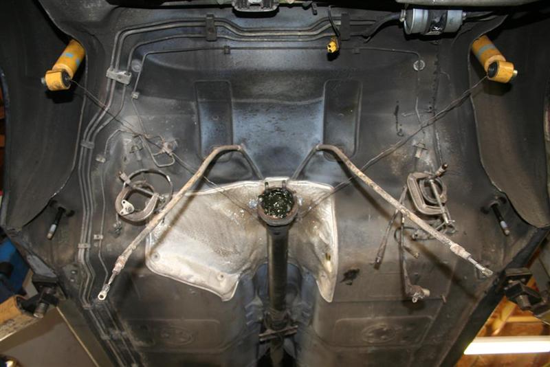

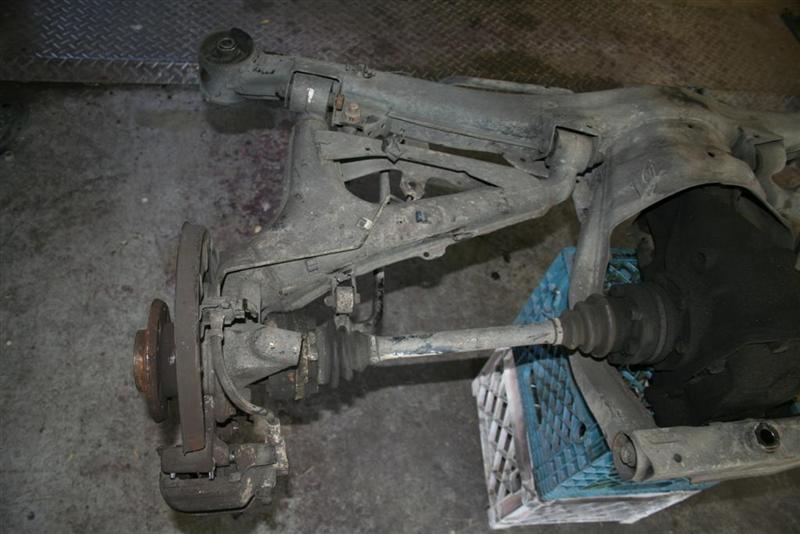

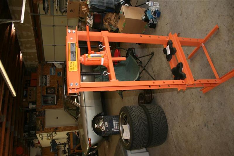

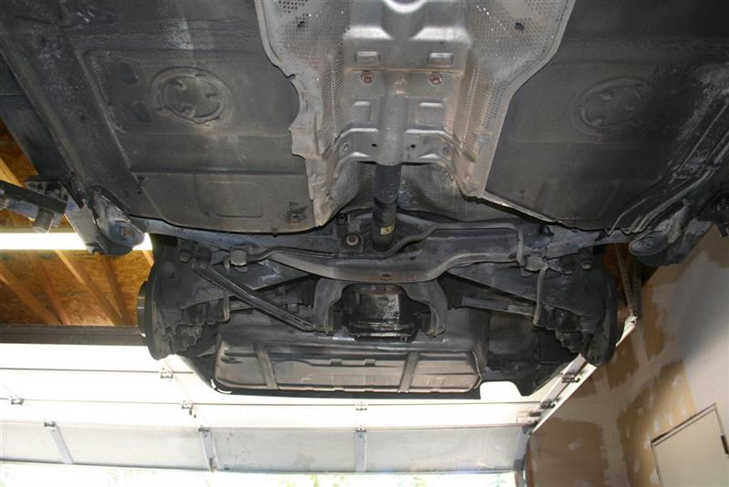

        Today I lowered the rear subframe to do all 10 bushings (did the 2 dog-bones/rsm's already). Picked up a 12ton shop press to help with the job tomorrow.

          Couple more from today.

            Press from Harbor Freight.
              #36

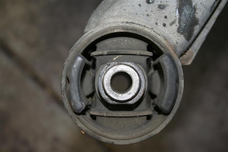

              Well, epic fail today. Not a single bushing would come out, 12ton press ended up being useless lol.
                #37

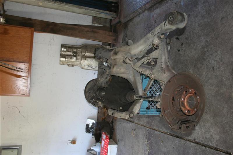

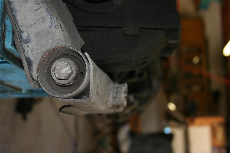

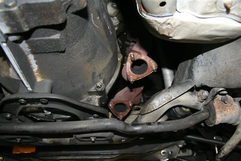

                Picked up the trailing arms with new bushings pressed in earlier this week. Just finished working on the car 10 hours straight.
                Completed the following:
                - installed trailing arms in the subframe
                - installed diff in the subframe
                - installed axles
                - removed drive-shaft, replaced guibo
                - removed shifter console and all parts
                - installed new shifter components and e60 shifter
                - installed subframe with trailing arms and diff on the car

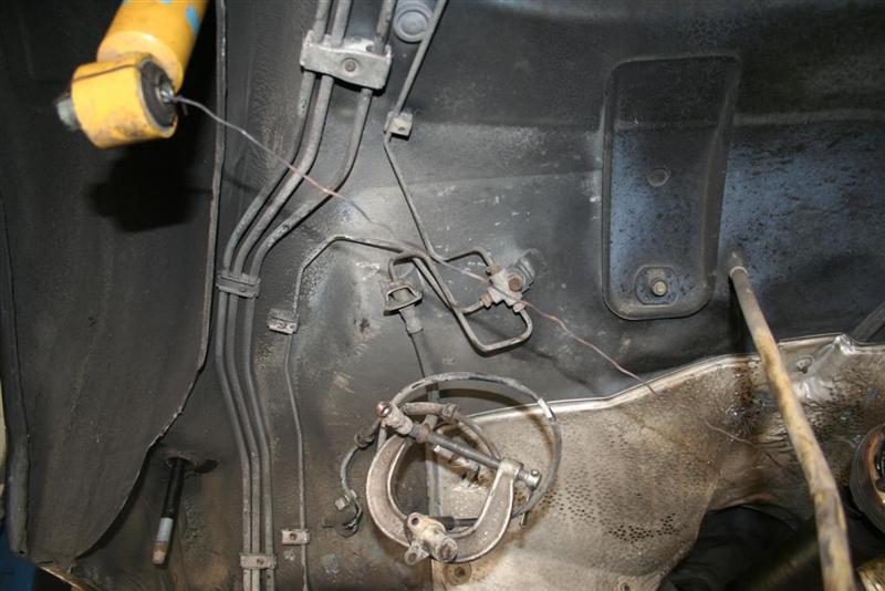

                - installed e-brakes, rotors, calipers, lines
                - installed drive-shaft

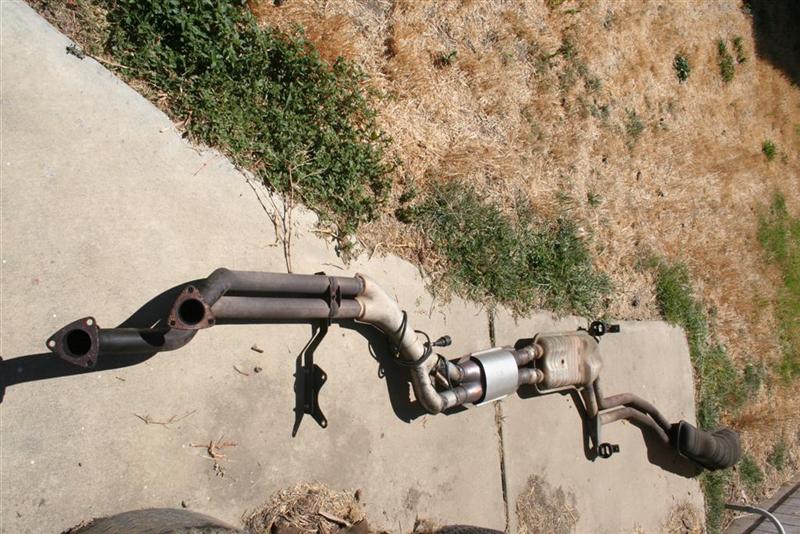

                - installed exhaust, new gaskets, and a new stud (one broke).
                Tomorrow I just need to bleed the brakes and take it for a spin with ALL new bushings now. I just forgot to replace the rear sway bar links, but they seem to be okay, not cracked so they'll do for a month or so and I'll then replace them and maybe get new sway-bars.
                I'll probably end up replaced the steering box next, as I still have a little bit of shake even with all new lemf/meyle hd front parts (every single part replaced including rotors/pads, sway bar links).
                Took some photos today -
                e60 shifter and shifter parts
                new trailing arms bushings installed
                new subframe bushings installed
                new diff bushings
                trailing arms installed, getting ready to install the diff
                new guibo
                old shifter vs new
                installed
                installed axles
                lining it up for install
                making some progress
                10 hours later :)
