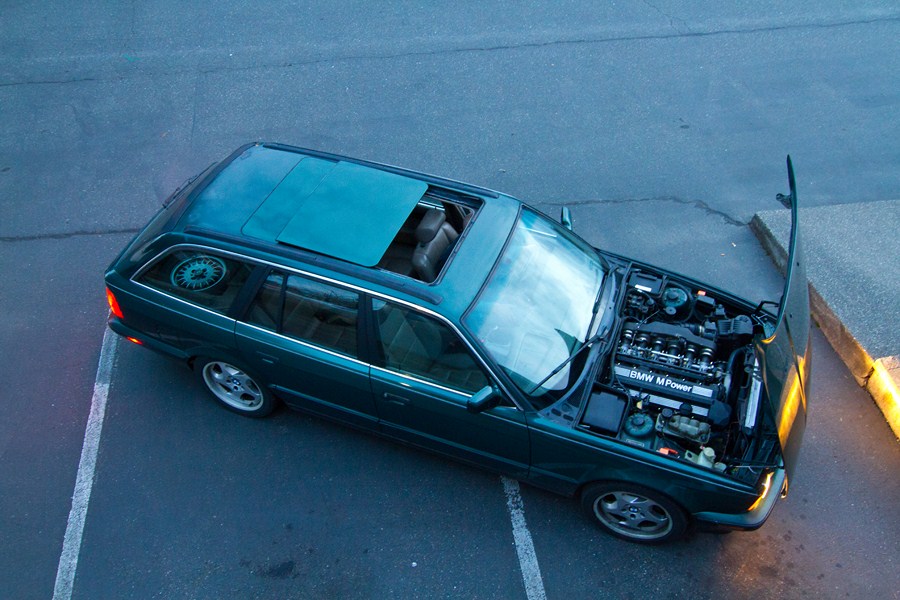

    Parts hauler....
    A quick shot from today
    It has been a champ at Costco runs, and even carried its own replacement tires to get mounted the other week :D

      joking aside, nice. I am looking forward to having a car with this engine soon. Anything tricky about the swap in terms of marrying the electronics?

        Looks sick as shit. What are the specs on that S38?
          No EWS or anything, treat the harness like an M30 E34 harness (all E34 M5's were based on the 535i)
          For my swap the car had an M50B25 / Automatic and I just plugged the harness into the car. Had to run 1 wire for the oil temp gauge (ETM has all that stuff) and it was done.
          Amazing motors, the noise is just something to be experienced. Just keep up to speed on valve shim adjustments, and don't go about 3k until the oil is ~200F.
          Its just screams at 7000RPM
            Hah, if I had an E39 I'd insist on doing an S62 swap. Fast wagons are hot!
            Base specs are 310hp and 266ft tq, however I have the S38B38 exhaust camgear and Dinan software.
            Dinan CLAIMS 350hp at the crank so who knows. I have driven a stock E34 M5 and I certainly have a ton more midrange power so its possible.
            Dinan spec sheet on the upgrade.
