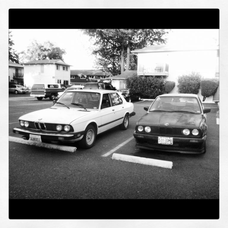

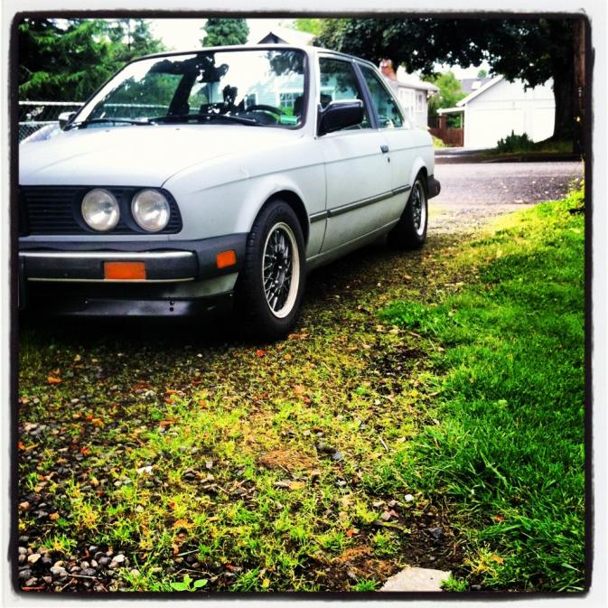

    It's an 83 528e completely stock. I'm third owner.
    The car has no major mechanical issued. It runs and drives great. It has a few minor flaws. The back windows don't work, and the front passenger window only rolls down 3-4 inches.
    The other problem is: it smells like coolant in the car. I can't find any leak. And the carpet is dry? Any idea what I can do to fix these issues?
    One more thing, the rear set belts feel like they've never been used. They are very stiff(starchy). What can I do to soften them up

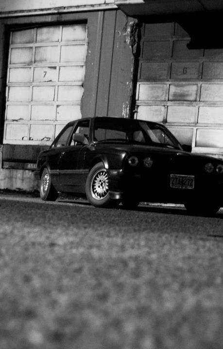

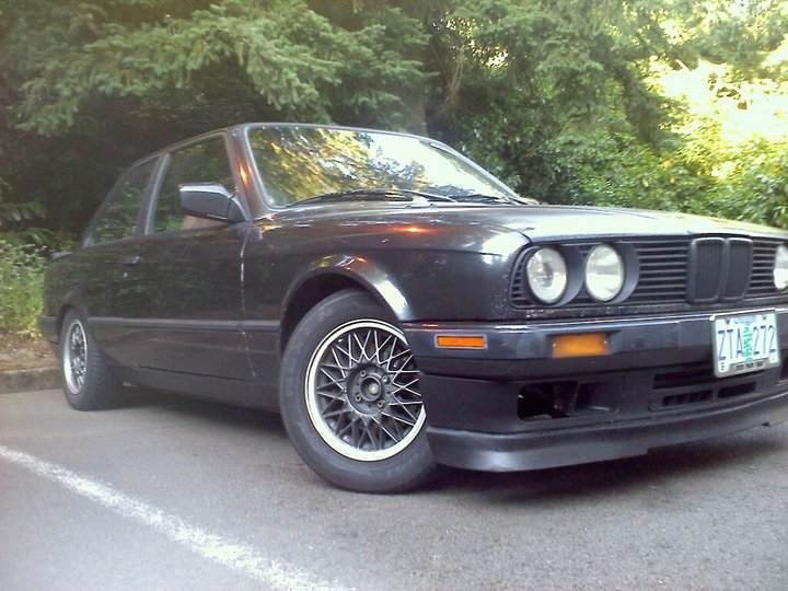

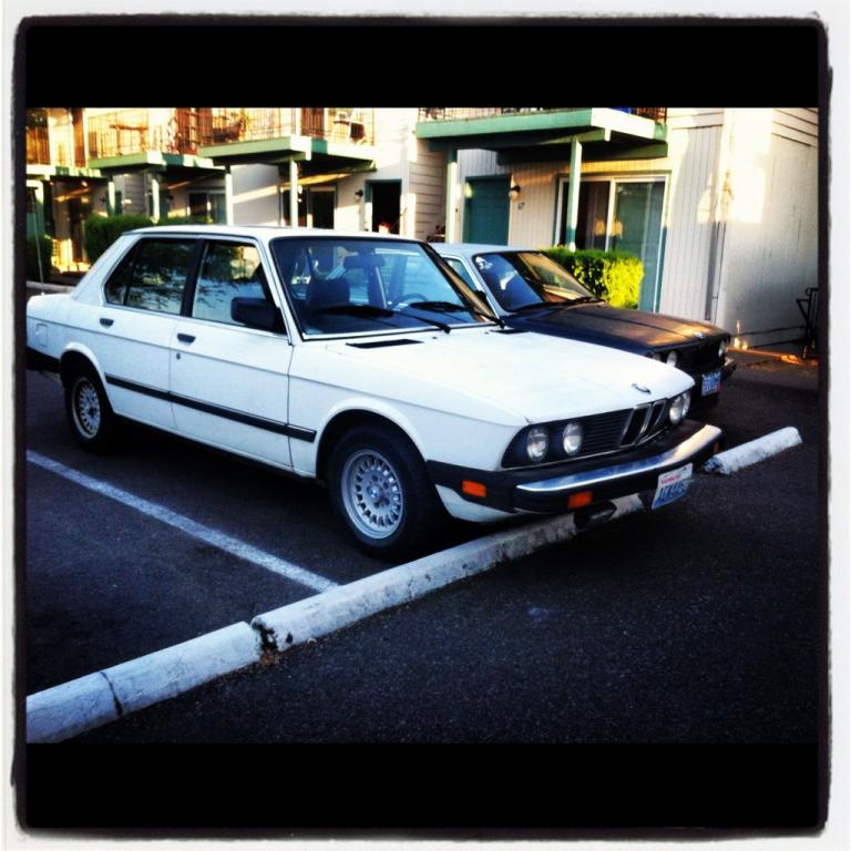

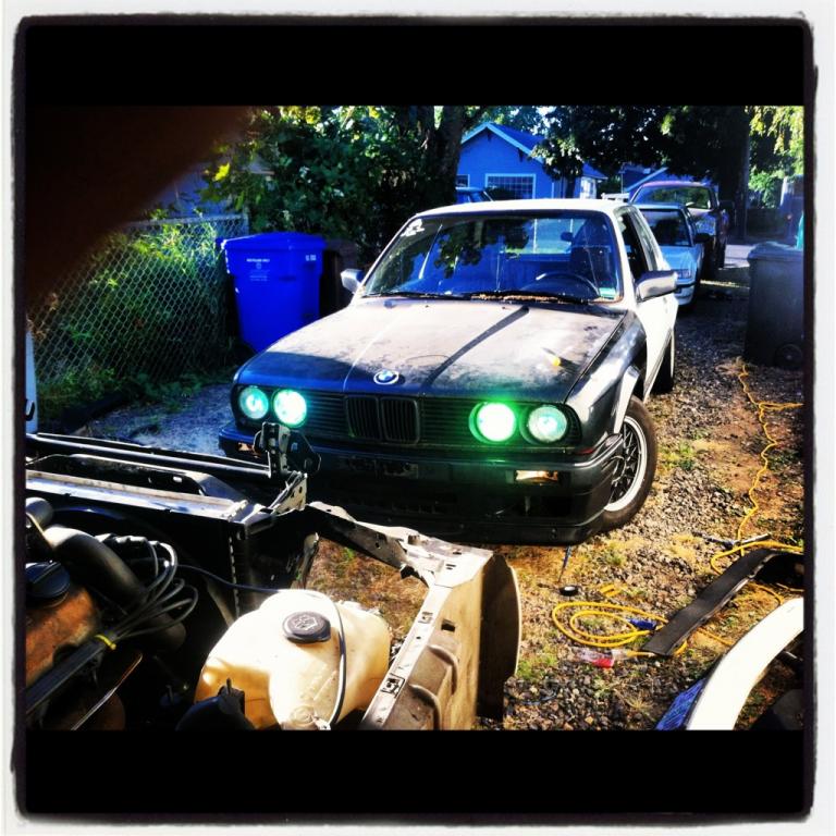

            I have 1.5 e30's an 85 eta and a 91 325is parts car
