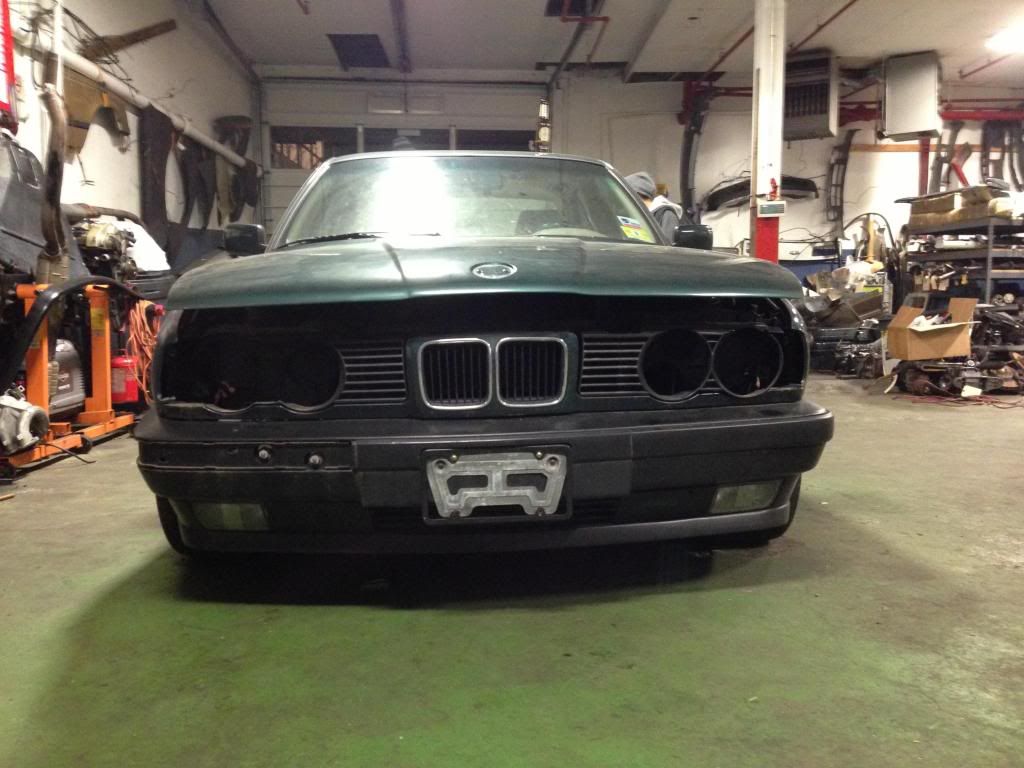

    Normally would have chosen an E30 but this came at a good deal so couldn't resist. Just returned from 2.5 years abroad and back to the shop so i need a DD quick. Will get it to a nice sell-able state and then sell it in a few weeks.
    However, I can see it growing one me ;)

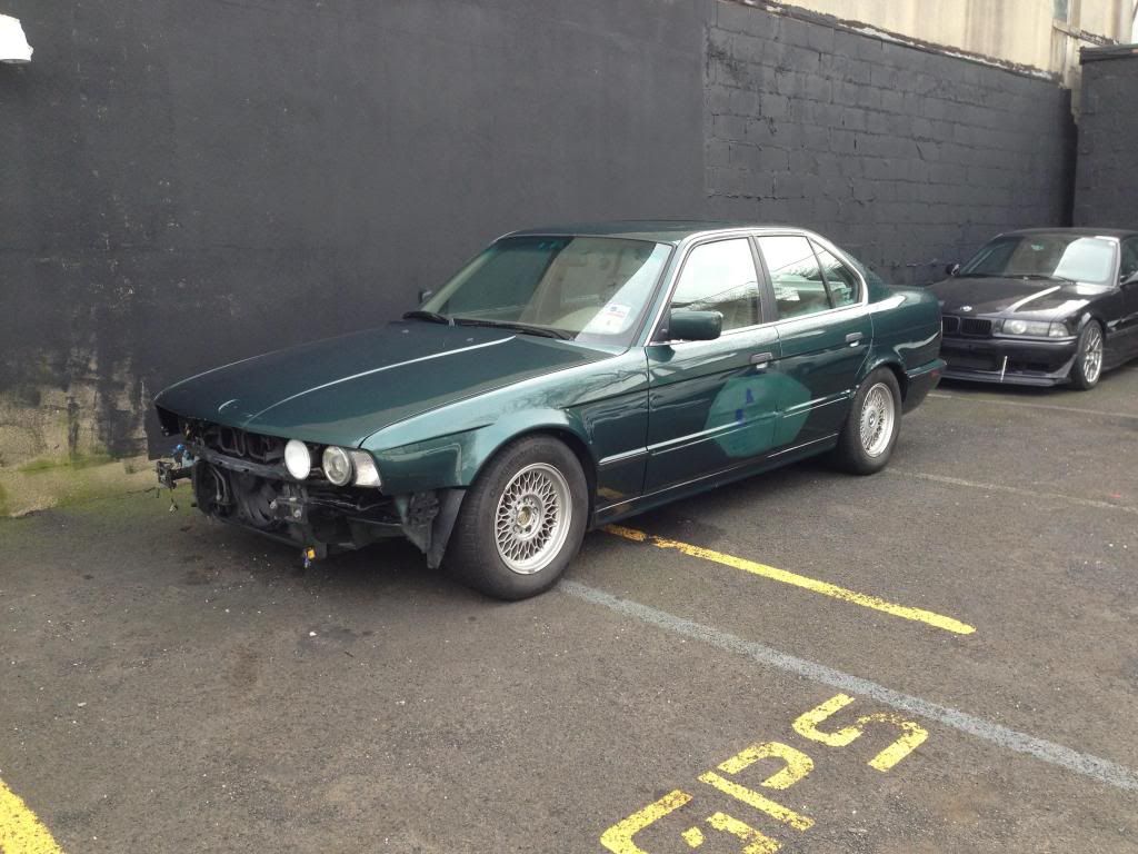

    1993 525i 5-speed. 203k miles, Island Green on Parchment

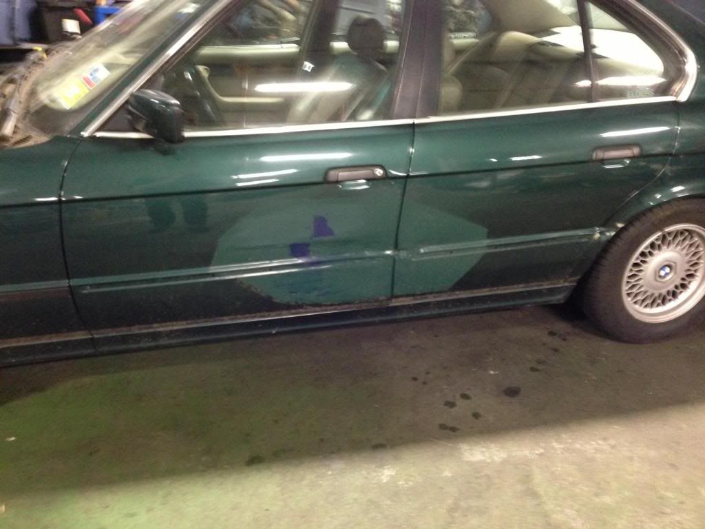

    Front end and drivers side damage. Already has a new, unpainted fender and bumper on it. Still need to source matching doors but no hurry on that.
    Remus exhaust, Dinan chip, H&R with Bilstein sports.

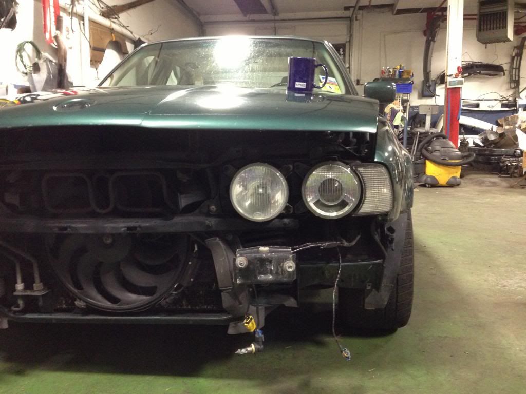

    Missing all lights, all the way around :shifty
    First pics:
    Com'on
    First night of work, needed some motivation

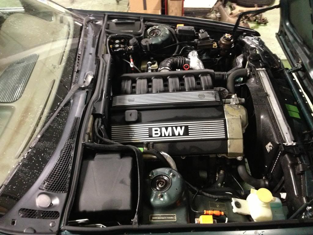

    Cleaned engine bay
    Rewired drivers side for smilies

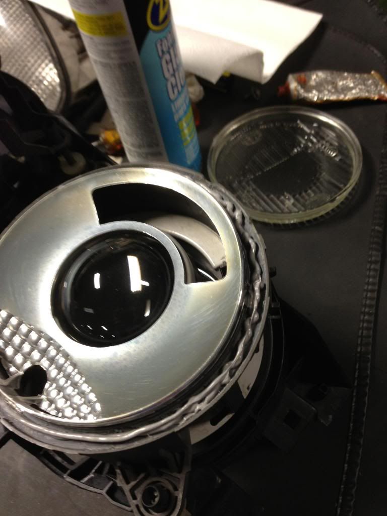

    Passenger side glass just FELL off when trying to install so here i am prying out the old sealant
    New bead
    Glue dried and powdercoated black rings on

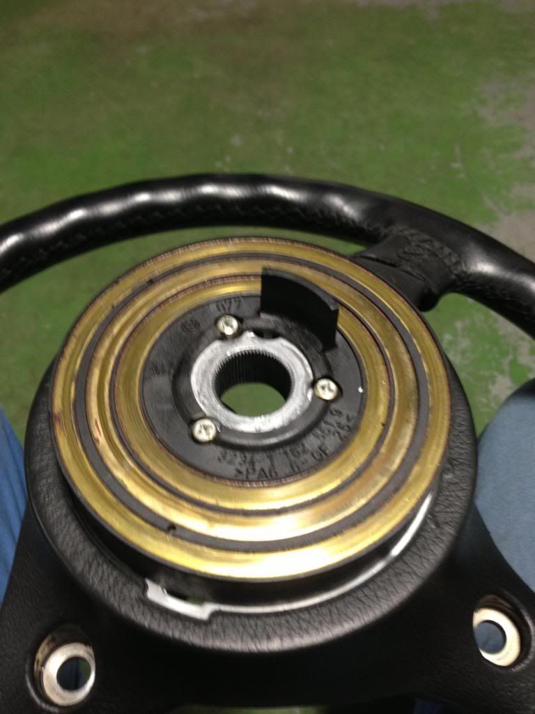

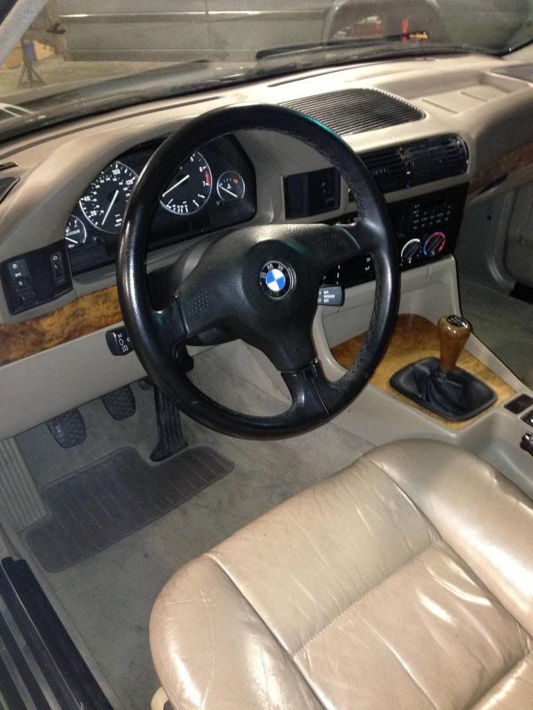

    Euro Wheel (I believe its a Euro M5 wheel) fits but needs a little modification. I will not have the airbag connected

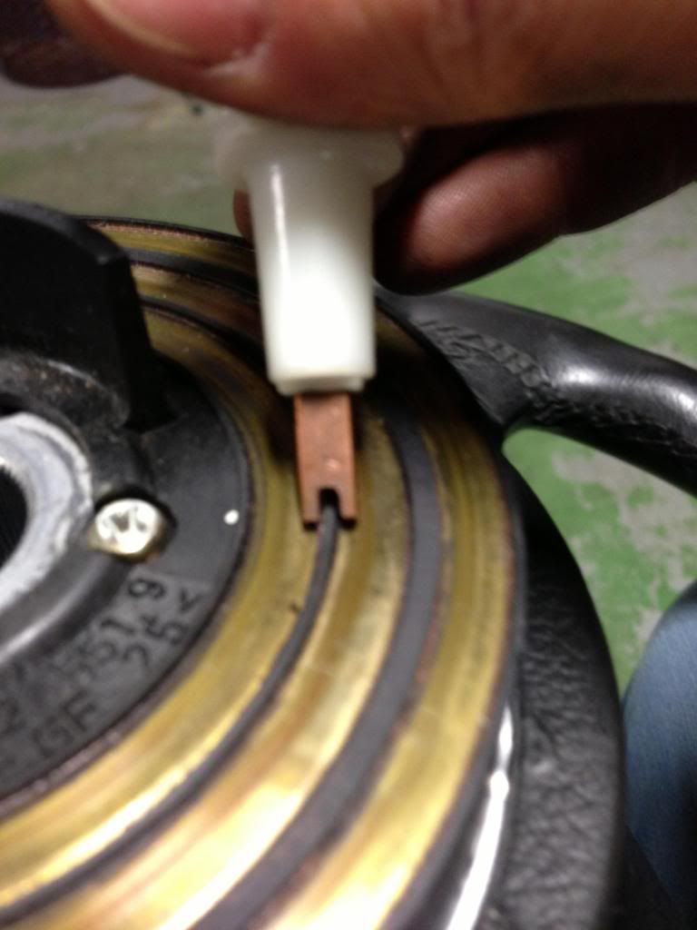

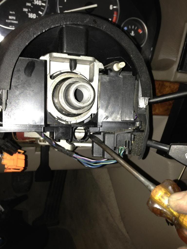

    The horn post won't contact the ring, gets held up by the plastic ring between first and middle contact rings
    First step, dremel a slit in the middle of the post so it will contact the first ring
    Second step, dremel a small slit where it sits in the steering colums so you can rotate it 90 degrees
    Finished product, oh yeah

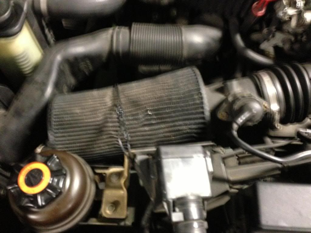

      I lolled at the air filter. Looks like an old sock.

        you want to put a stock airbox back in, that filter is sucking hot air there.
        also that wheel isn't an M5 wheel, its an SE wheel, so yes it was an option.
        this is the stock non airbag early wheel
        and this is the early M5 wheel aka MTech1 (installed in an M6 in this photo which has the same wheel as E34 M5)
        and this is the later M5 non-airbag wheel aka MTech2 (i have this in my car)
        but you could option any wheel onto your car eg you could option the Mtech2 wheel onto any E34 from approx 1991 on
