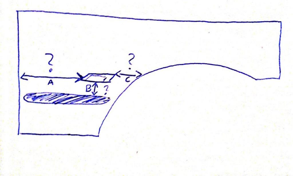

    Hey guys.
    I'm desperately in need of some help.
    I've just imported a BMW 525i from 1990 and in order for me to put it on the road, I need to mount side repeater on the front fenders. I wanna do this as original as possible, so I would really appreciate it if one of you could tell me the dimensions I've drawn in the attachment so I can put it in the right place.
    A is the distance from the rear of the fender to the "tip" of the indicator
    B is the distance from the wheel arch to the "tip" of the indicator
    C is the distance between the indicator and the plastic trim.
    I hope you can be helpful and thank you very much in advance.
    Nicolai

    Worst case, find a MY95+ fender to measure off of. I tried to search for ya, but it seems this info is a lot more available on the e30 around here, but it seems no forums have this data handy.

        I measured the driver side, so it's opposite of your drawing, but here you go:
        168mm down from the edge of the body line
        158mm from the back edge of the fender
        Opening measures 23mm x 58mm
        Screw hole is centered vertically and 18mm in front of the hole. There is a plastic insert that goes in the hole for the screw.
        This is on my euro 94 525ix touring.
