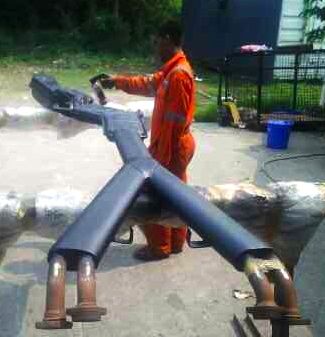

                        I went ' NASCAR Y PIPE ' on my M60 to help the engine breath using 4" pipes flattened to an oval with a hollowed out centre muffler and a used E34 M5 rear muffler I had in sitting in the workshop.
                        Peak power moved from 5,800 to 6,250 rpm and kept making power to redline without drop off
                        You could also do this using CATS , start the system after the CATS
                        The video was still M60B30 , now M60B40
                        For a budget build , chip and exhaust will give the best bang for buck. After that it's diminishing returns.
                        If you come across a cheap M62B44 you could build an M60B44.
                        Converting to a manual is a big pain , better to find another 540 manual eventually , move all your good parts from the 540 auto and continue to enjoy the E34 540 . They're a very under rated car and addictive to drive.

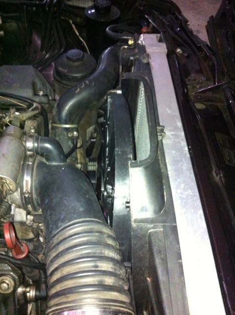

                            Another tip is to delete the viscous fan clutch.
                            You can use an E34 auxiliary fan in the puller position , it fits
                            It's worth another 1.7 RWHP on the dyno and eliminates the terrible fan noise and risk of fan clutch explosion
