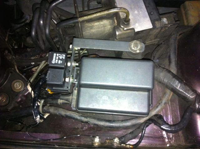

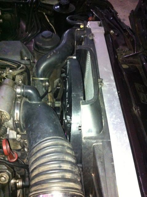

    2. Custom cooling system using a aluminum radiator and electric puller fan (no more fan clutch problems or explosions)

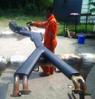

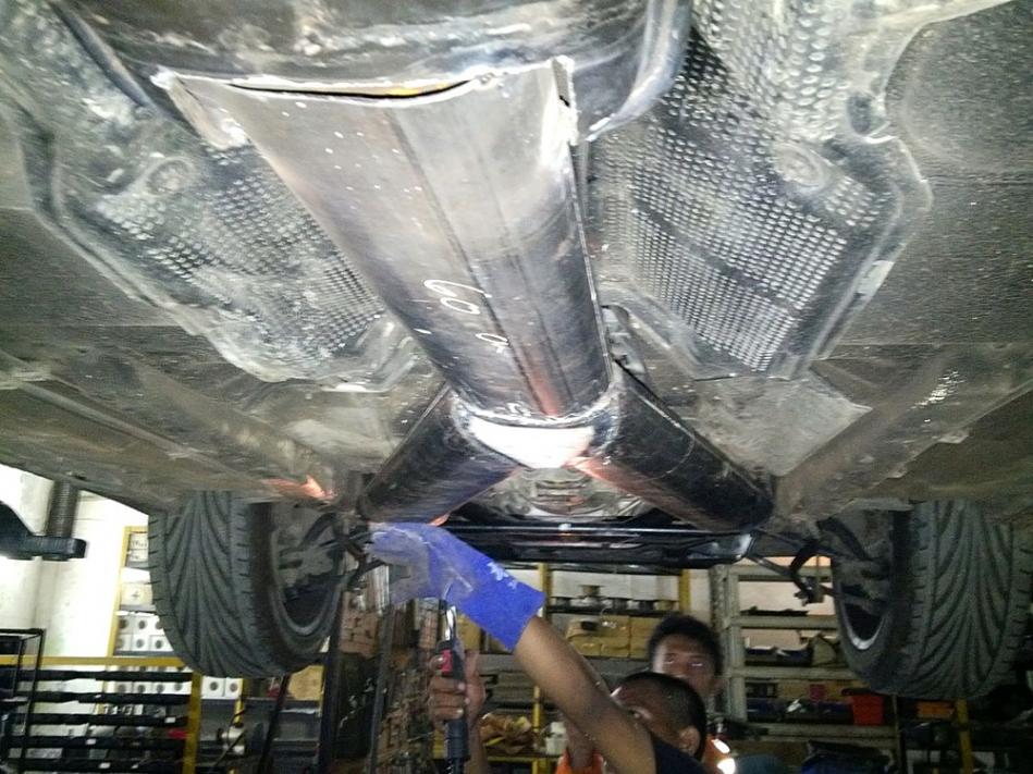

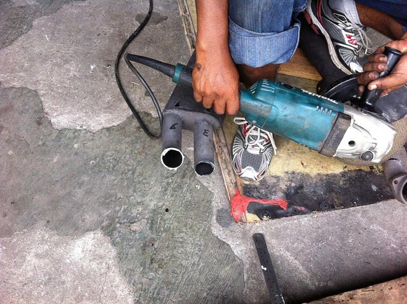

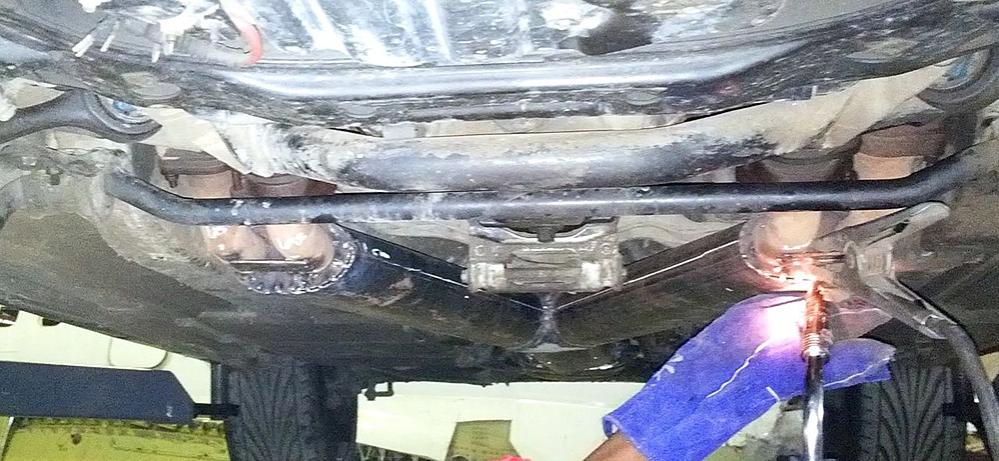

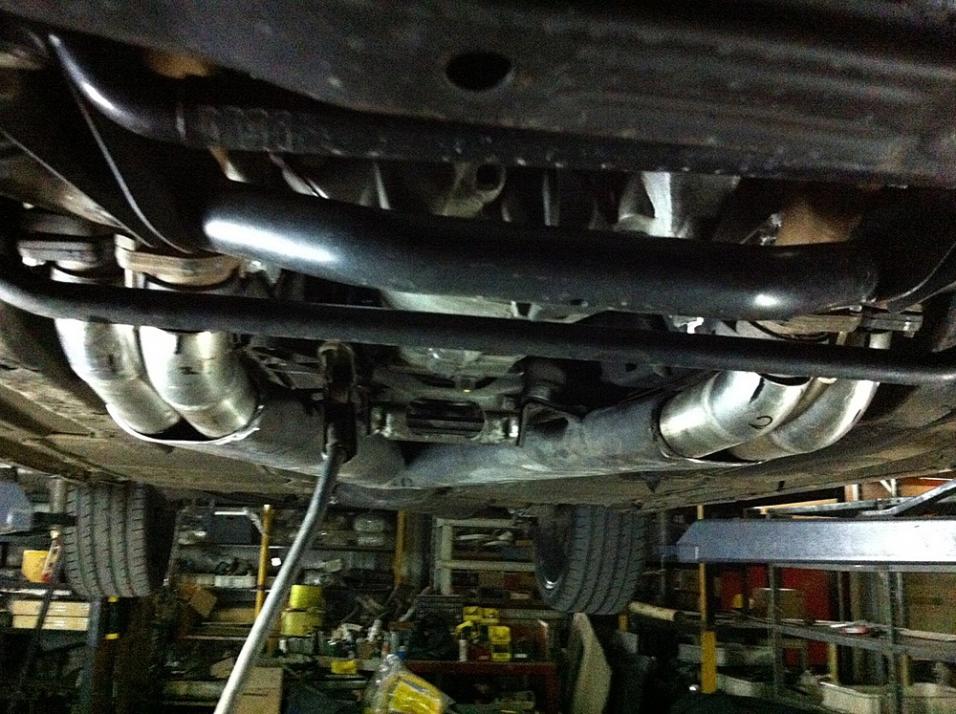

    3. Custom 4" Nascar style Y pipe system with custom rear muffler.

        I upgraded the pipes into my custom expansion chambers
        The 4 x 40mm dia pipes must have been glowing red hot at high rpm (700 deg C plus)
        The new pipes are 4 x 60mm ID 316 stainless steel and discoloration showing temps around 400 deg C now
