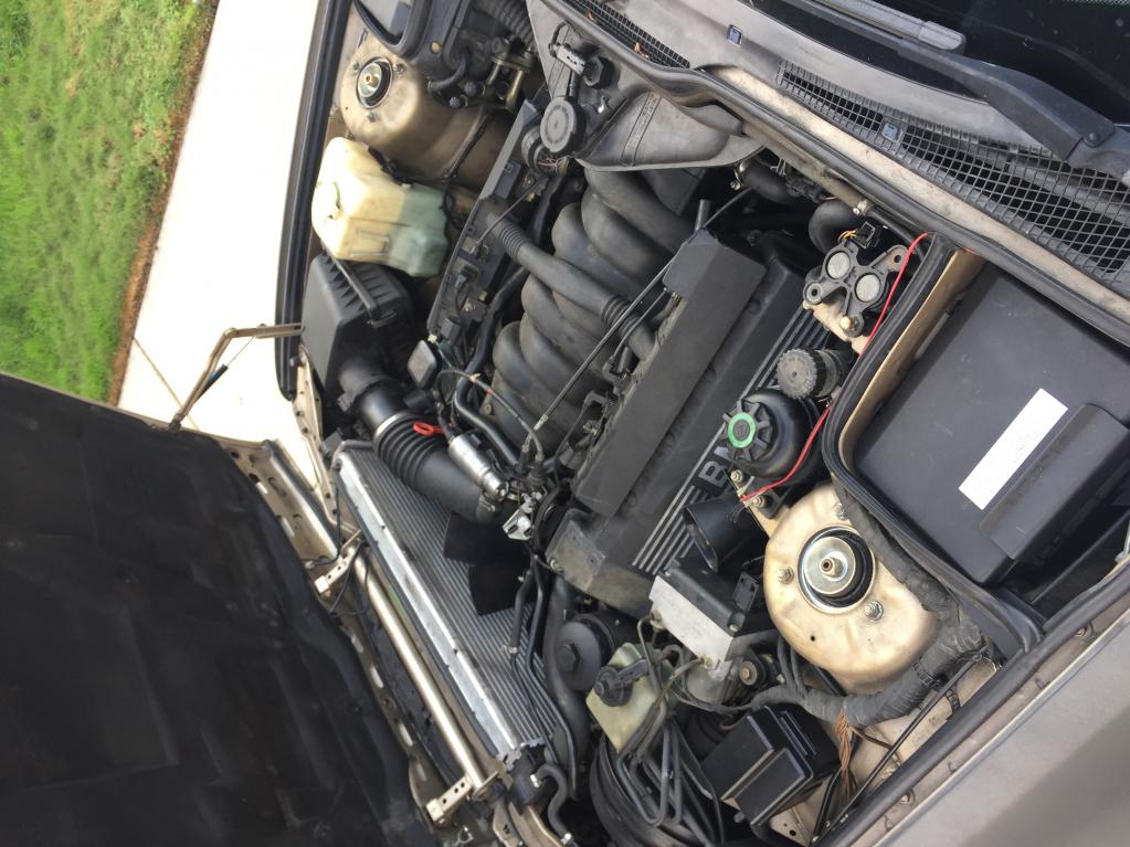

    Hey guys I just bought myself my first e34 today. It's a 1994 530i with 202k miles 5 speed basically stock with lowering springs no muffler new cat and new brakes. I don't know anything about e34s, I drive an e30 so this is all new to me! Just wondering what engine mods I can do to get the most out of this v8 and what exterior stuff to do to make it look clean!👍🏻 Let me know, thanks!

      it looks like someone already did the 4.0 intake swap, which is nice.
      an engine chip is really the only other engine upgrade, as unfortunately there is really no support or parts for the 3.0 motor.
      exhaust is worth upgrading for the sound - these v8s sound amazing when opened up!
      after that, the next best value is swapping an entire m60b40 motor, which is a direct fit and will net you 290hp versus the 220 stock hp.
        I had no idea the 4.0 swap was direct fit?! No need to get a new tranny or any of the other shit, just plop it right in?! Definitely on my list!

          you will need to put together a new flywheel/clutch setup to mate it to your existing 5 speed. the stock 3.0 clutch will not handle the extra torque. otherwise, yes a direct fit. its on my list to, just hard to come across an 4.0 m60 around these parts without it being 200,000+ miles already
          here's some info on setting the clutch up for a 4.0 m60 with 5 speed (a common setup for e30s with m60 swaps): http://www.r3vlimited.com/board/show...7&postcount=54
          and the whole thread where that post comes from is here: http://www.r3vlimited.com/board/show...=223866&page=2
