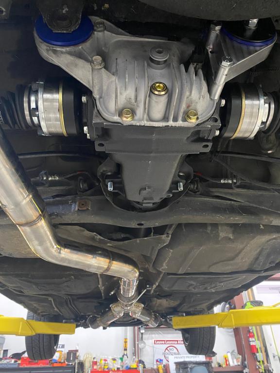

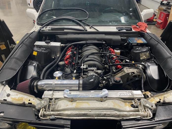

    My red one was painted last year posted some pics of it here. My white one got a less then stellar paint job and will now go to the same person that did my red one. White car got my ls motor. An asa ls and new mid sized rear lsd diff with dss axles.

    Engine management: holley terminator
    sikky swap kit
    Sikky radiator
    Select Ratio: 3.73 , Select Limited Slip Type: 2 clutch, REMĀ® Ring & Pinion Polishing, REMĀ® Differential Bearings Polishing
    midcase
    Driveshaft shop level 5 m3 axles
