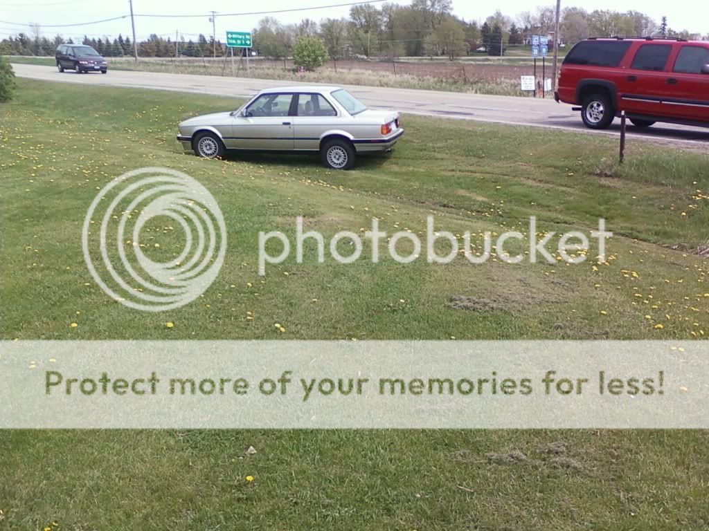

      Engine power completely cut in a busy intersection.
      Dodged a few cars, ended up in a ditch on the other side of the street:
      Gas tank was over half full, but we tried filling it anyway, to no avail.

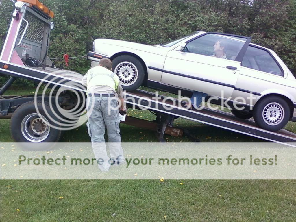

      Engine will turn over but refuses to ignite. Waited two hours for a tow to my dad's repair shop, hopefully I'll find out what's wrong with it Monday.
        someone ran the tank on empty too often
        good to hear you werent hurt
          Sorry for your bad luck. Check/replace your main and fuel pump relays.

              probably not the first time something broke on a 20 year old car, but thanks for pics!
                is it an M20?
                  the exact same thing happened to me a few months back...turned out to be the crank position sensor. i wouldnt start there, but its something i would check if the easy stuff doesnt fix it.
