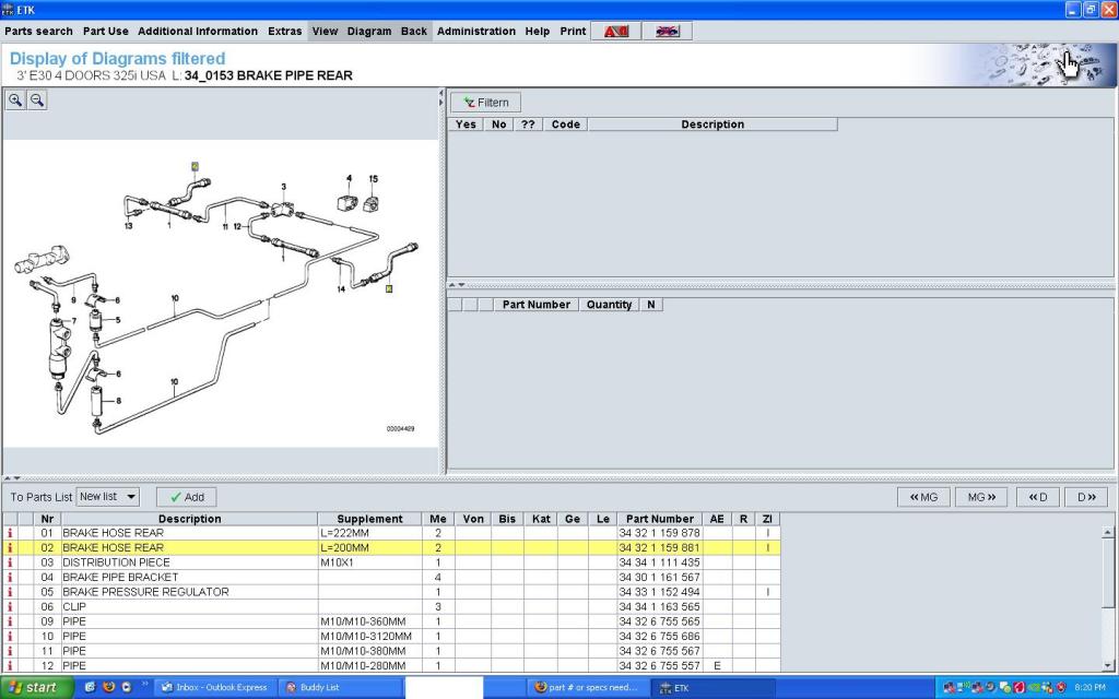

    I broke the hydrolic fitting that goes between my brake calipers and my brake lines. The one that threads right into the caliper on the rear. I need a part number or some gerneral specs on it to replace it. If I can'replace it i am fucked! Thank you in advance.

    www.realoem.com

      thanks, no one has that part, big suprise. I checked there b4 i posted and it only had the line, i guess the fittings and line are all one part number. I'm fucked

        This?

          I can't find the hose/fittings for the rear but i have one from the front, it is a little bit longer. Does anyone think this would work? It should since it is longer versus shorter!
          • thedeal
            • 643
            Had a new Stainless steel line fabbed up to match all the others. Problem solved. Thanks for the input.
