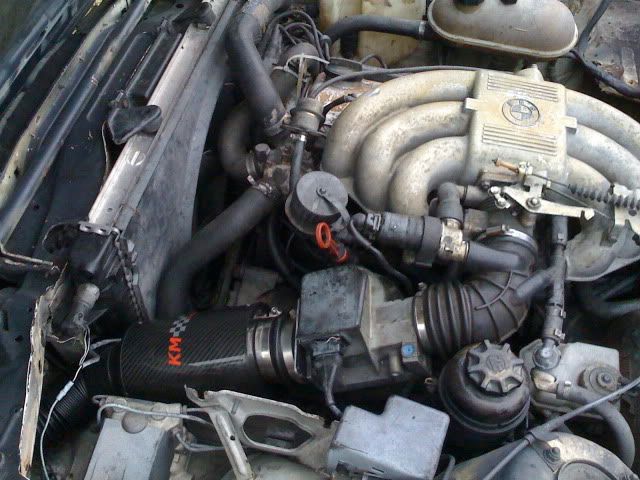

    AFM
    Theres nothing wrong with it,, but is it ok for my afm to be in this position? I just installed the KA Motors CAI and it works great.

      the AFM looks ok at that angle, but it will provide with some erratic on/off throttle response. Reason i say this is because the AFM typically should sit horizontally as the weight of the flap with AFM in any other position will obtain gravitational effects.
      looks like a b25 swapped into an eta that was in a front end collision. there could be any number of things up with that clicking ... from bell housing area?
        where do i connect it to the temp sensor? and its an original 325is with the m20b25 engine.. its not a swap
