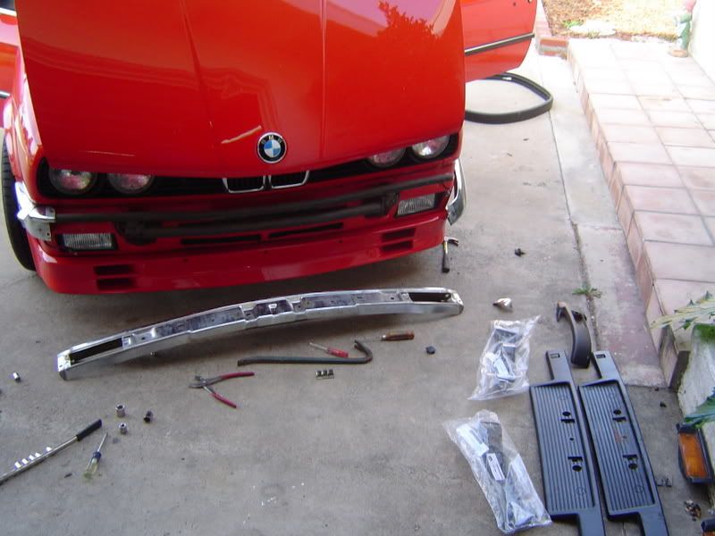

                          • arch4ngel
                            • Dec 2008
                            • 791
                            Here's a pic of the front:
                            Looks completely different from SoCal323i's.
                            Didn't have a chance to put it on a scale but it weighs probably twice what the bumper itself weighs.
                            I tried to take a close up of the core damage but it didn't come out right, but you can tell the brunt of the impact was taken by the bar.
                            The bumper is a bit wavy but very little damage overall, compared to the bent mounting point of the bumper core which is some heavy duty steel.
