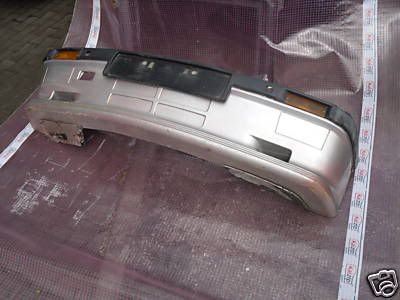

                      this is mine
                        Originally posted by Dixon View Post
                        this is mine
                        So cut accordingly :D

                            A pic of my Mtech 1 installed on the S38.
                            My lower 2 panels are cutout for the oil cooler.
