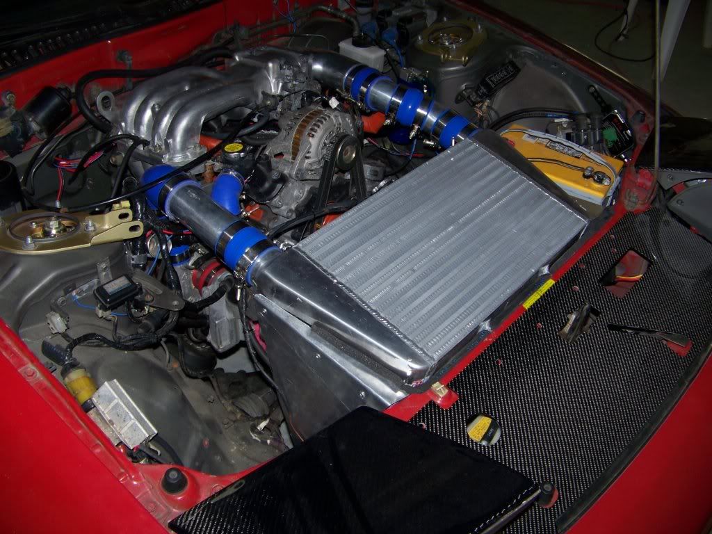

    It's a 1987 Mazda RX7 Turbo II, it is powered by a single turbo 1,308cc rotary engine. I pretty much rebuilt the entire car based on a brand new engine, stripped the car down bare and replaced whole drive train with new or low mileage components including upgraded clutch, pressure plate, transmission and limited slip differential. The engine management, fuel and timing is handled with an Rtek7 Stg 2.1 ECU upgrade, fuel is supplied by 4 x 720cc injectors and rewired 255lph Walbro pump. I'm currently running a BNR Stg 1 hybrid turbo -TO4B v-trim - and using GReddy Profec B Spec 2 for boost control at 12psi. Custom VMIC, FD manifolds, all emissions removed, 3" turboback exhaust, Stance GR+ coilovers, slotted/drilled rotors, 17 x7 and 17 x 9 wheels, etc..... Too much to list, it took over 3 years to build and isn't even really finsihed but it's at a comfortable point for me.
    Anyways here are some pics-
