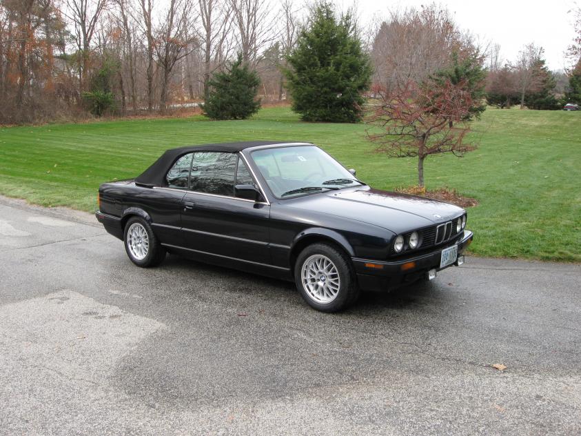

    pic is the day I droppped the car back down
    today I have to put the bottle caps back on :( they have better winter tires
