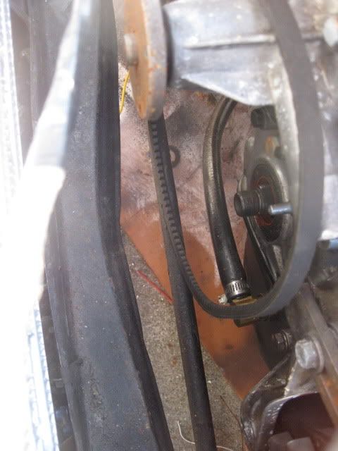

oil line from oil filter housing
Oil Feed on turbo
Oil Return on Turbo
Oil Return Into Tank.
Obviously the return to tank is just a hose, but there were return lines that fit to the turbo that that hose will fit over.... Defintiley will be going threaded line if I can figure out the right measurements

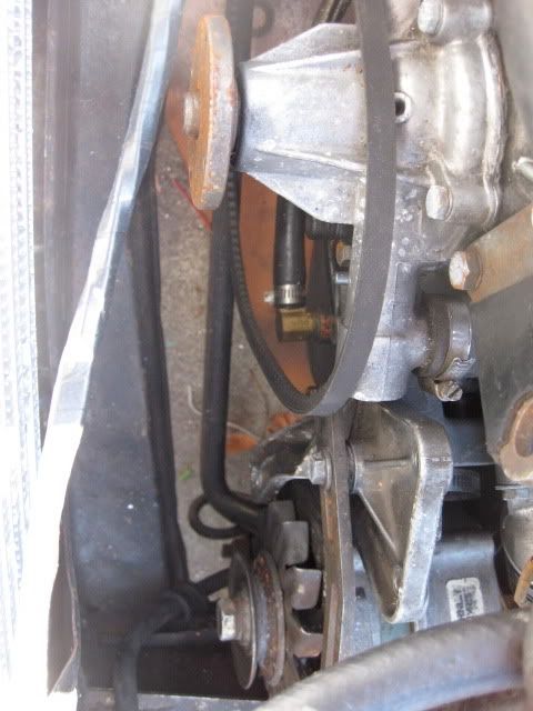

Next Up I got the Crank Pulley
EDIS bracket
pulley installed
trigger sensor and pulley installed JUST BARELY clears!
