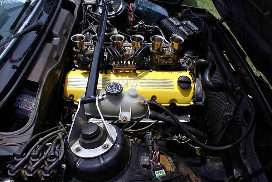

          yes you can fit the dcoe carbs +manifold a few have been done over here on saloon race cars and sprint cars i/ll try to find em again and post details here :D

                  this sounds interesting
                    ^ is that an e21? nice

                      yes that is an e21,,,, looked good so posted it :D
