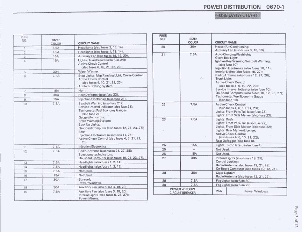

                  Have you downloaded your electrical manual?
                  Closing SOON!
                  Thanks for 10 years of fun!
                    i go with this one, i hope it's right.
                    Originally posted by e30e
                      yeah, that is just the power distribution chart. Get the whole manual at www.wedophones.com
