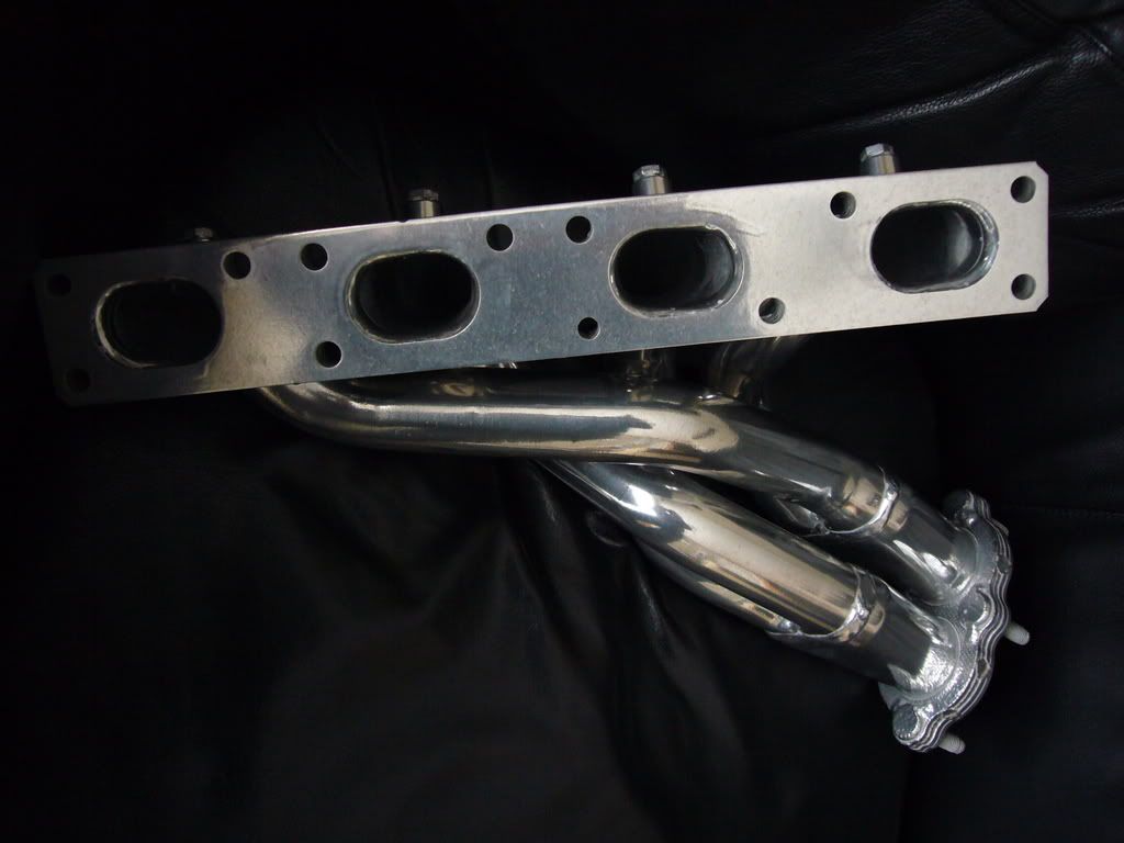

                            Ceramic works best, also keeps engine bay cooler. Here are picks of mine.
                            [IMG][/IMG]
                            • Hey-U
                              • Mar 2008
                              • 560
                              [IMG][/IMG]
