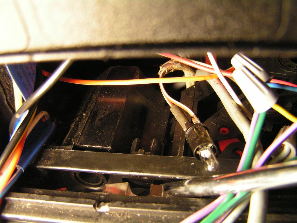

                    If you're replacing just the HVAC bulbs, you don't have to take the whole dash panel apart. Here's the easy way:
                    Temp Control Bulb Part# 63-21-7-167-000
                    1. Pull off the temp control and slider knobs
                    2. Pry off the small panel behind the sliders. So you don't gouge anything during removal, use a very thin blade electronics type flat screwdriver or one of those that you use to tighten the hinges on eyeglasses.
                    3. Remove the four screws that are now exposed.
                    4. Remove the radio.
                    5. You'll be able to see the bulb socket located above & right of the temp control knob. There are three small plastic prongs that hold the socket in place. This is one of those instances where it makes it much easier to just snap off the top prong, (already removed in pic) otherwise it requires a third hand to remove the socket. Don't worry, there are still two prongs to hold it in place. (You can also use a screwdriver to pry back the panel that holds the socket (see pic) and you'll see the bulb, but it's virtually impossible to replace from the front without using a small pair of needlenose. You'll be able to remove it, but try to get the new bulb seated in at the exact right angle without breaking it or dropping it down in the dash while doing so!)
                    6. Use your small screwdriver to pry back on the prongs holding the socket and pull it out of the panel.
                    7. Replace bulb. Make sure the bulb lights up before reinstalling.
                    8. Reinstall radio, dash panel and knobs. Done!
