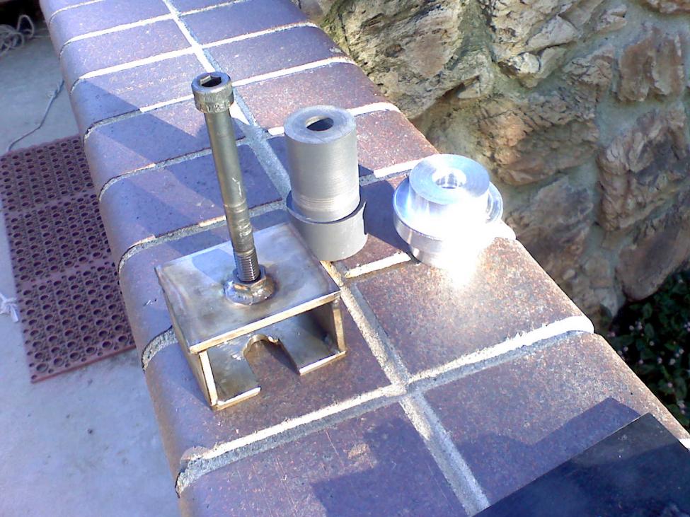

                      this thing works and i made it
                      stainless too!
