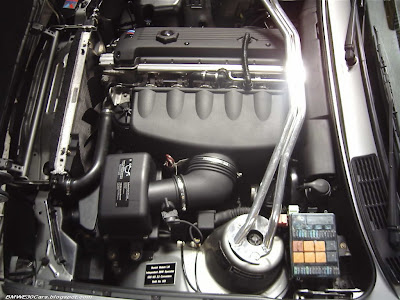

                    We transplanted the S54 into an e36 chassis but the velocity stacks used made booster clearence a non-issue.
                    I did find a pic of an e30 that appears to be running a standard booster of some sort though.
                    And a pic of the car I was working on for inspiration.
                          http://blankmediagroup.com/Pictures/Mike/E36-%20General/_DSC7660%20copy.jpg[/IMG]
                          yeah I have seen the pic... but after looking at my own fitment I have decided that it cant be a stock or any BMW booster and it cant be in the stock location unless they hacked the underside of the intake manifold. It just doesnt fit.
