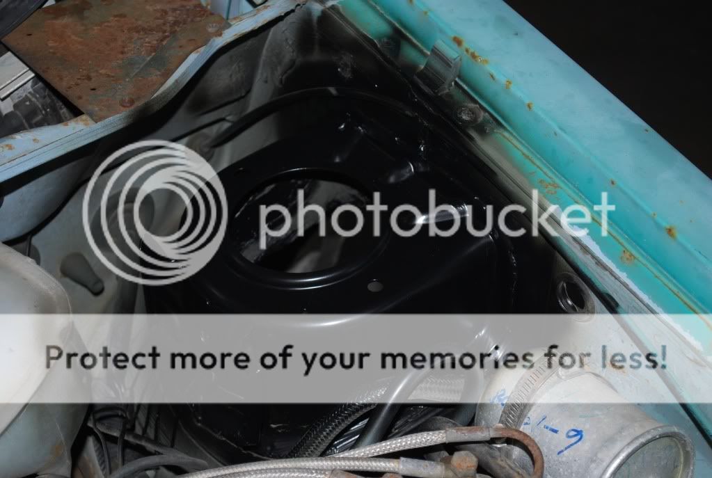

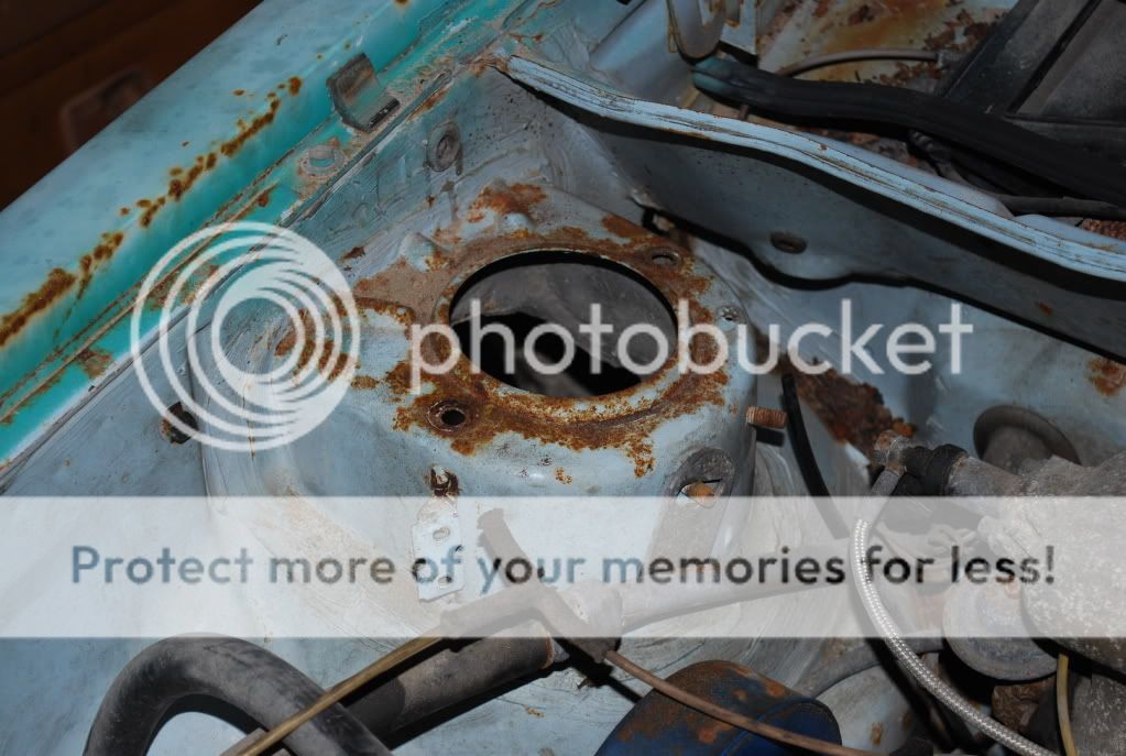

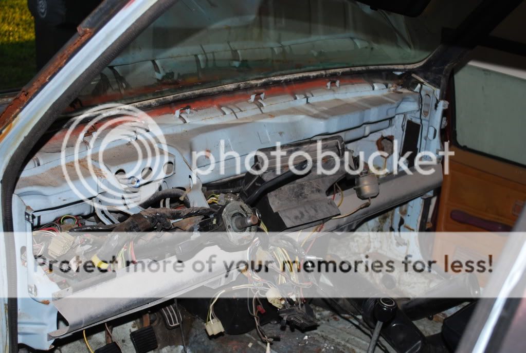

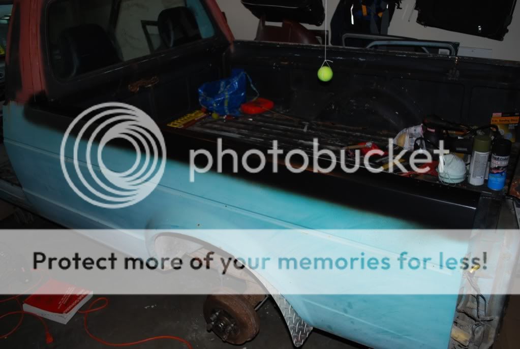

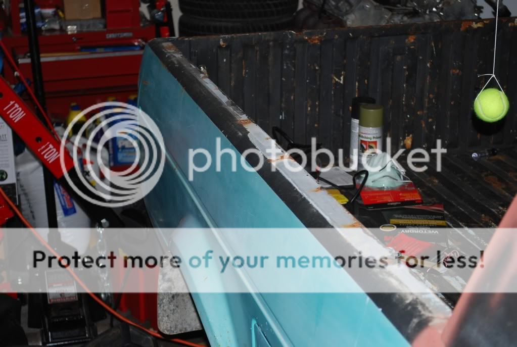

                Got a little bit of work done on it today. I didn't snap any before pictures of the sides I painted, but you get the idea of what they looked like based on what the other sides currently looked like. I didn't tape anything off in the engine bay, because I'm going to be pulling the engine and painting the whole engine bay sometime in the near future, but I wanted to get the strut towers painted before I installed the new struts/springs. I didn't tape the side because I'm going to get it painted/Line-x'd as soon as I weld up all of the rusty spots. In the mean time, I wanted to put a nice coat of primer/paint to prevent it from rusting any more. I also pulled the dash, because I'm going to need it out to cut out the a-pillars.
