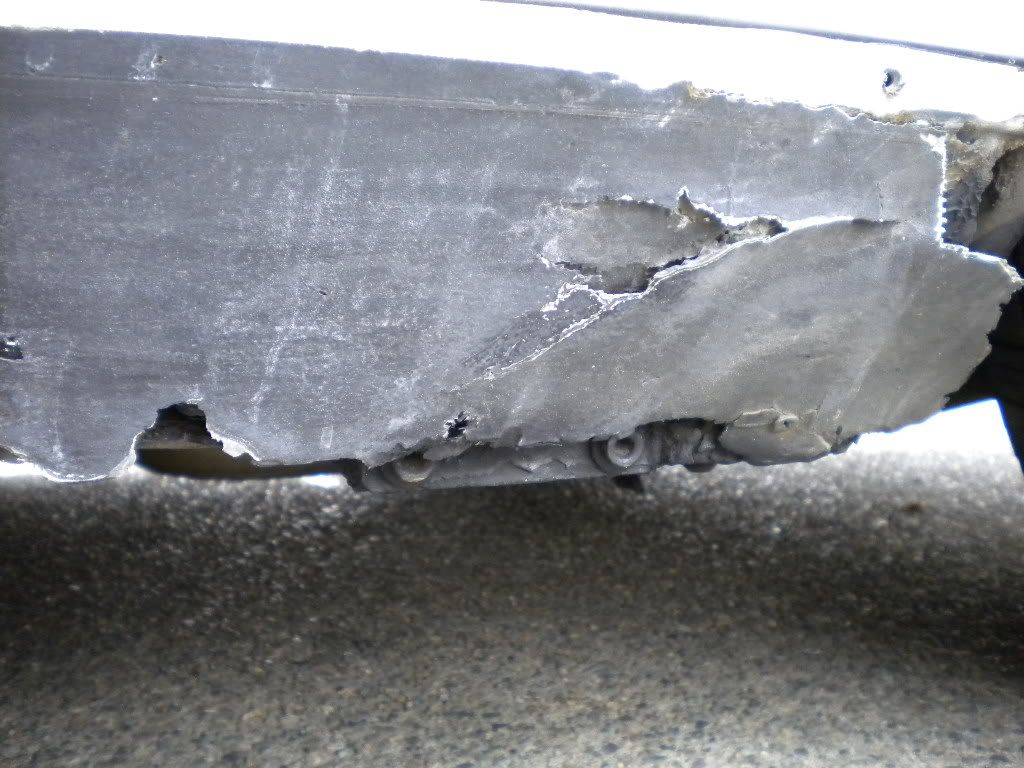

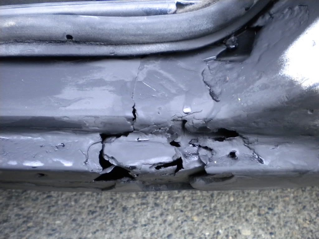

            Here's the hack "fix" the PO decided to do. Probably so he could sell it...
            Right at the rear of the door frame area:
            Here's right in front of the rear tire:
            Keep in mind this was all covered up by Taurus side skirts and fiberglassed/bondo'd. I had no idea until a small hole appeared on the top side when the fiberglass cracked. Decided to investigate further today and this is what I've found. There's probably more, but I still have to drive this car until I can get the new 4 door up and running reliably. My wife is, to say the least, pissed and because she's the sweetest girl ever, sad that someone would do this to someone else.
