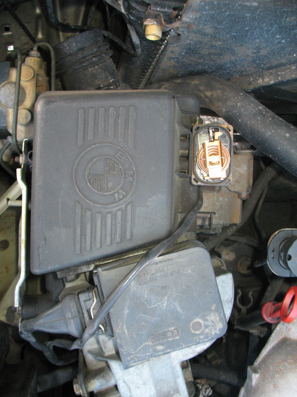

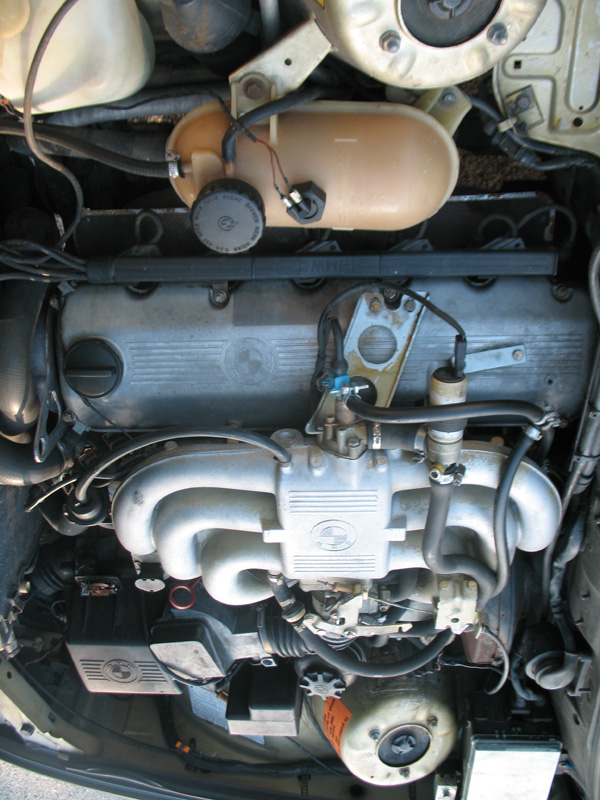

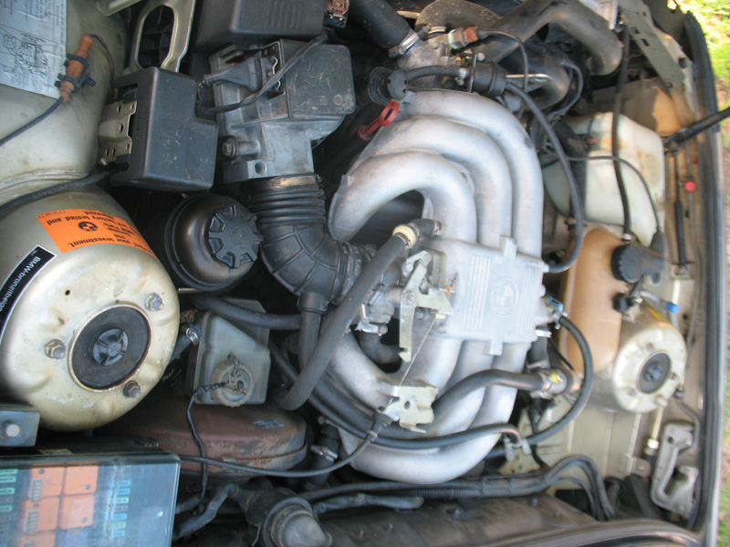

                  I snapped a few pics of the engine bay in hopes you guys can tell me what it is ... forgot to mention it's a 5spd manual and the redline looks like it's at 6250
                  What is this exposed thing on the MAF?

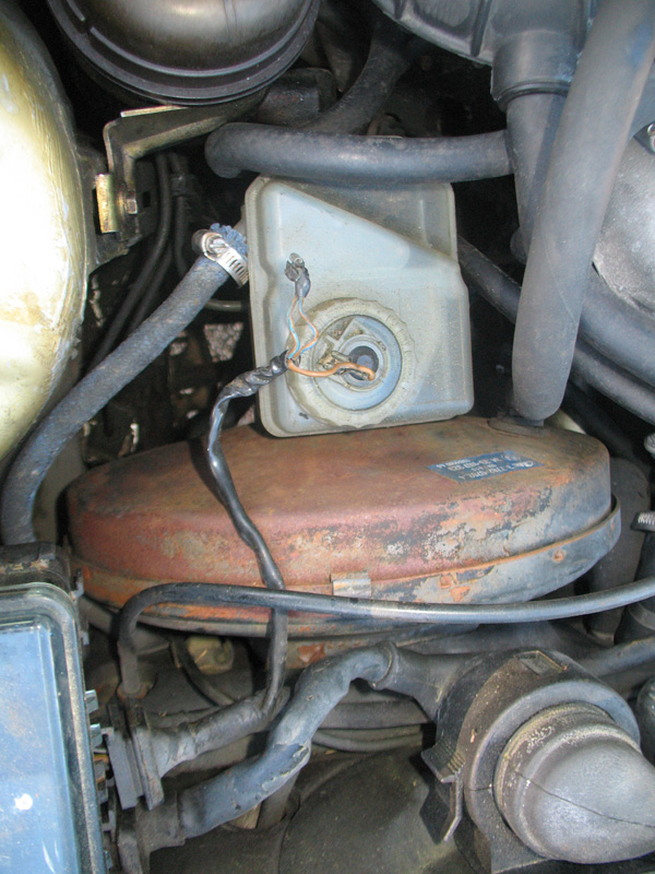

                  Looks like one of those contacts broke off the master cylinder ... should I be concerned? Sometimes the brake pedal goes limp .. car still stops though .. guy said he thought there was some air in the lines still

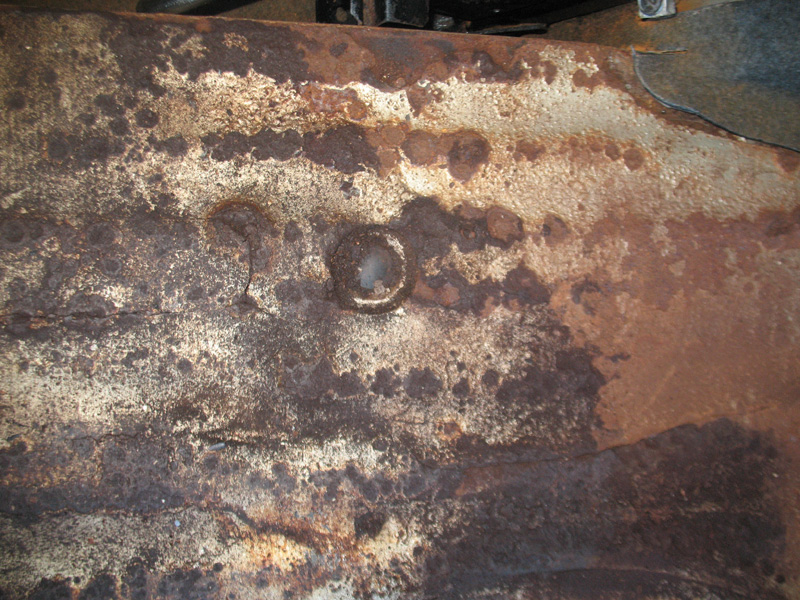

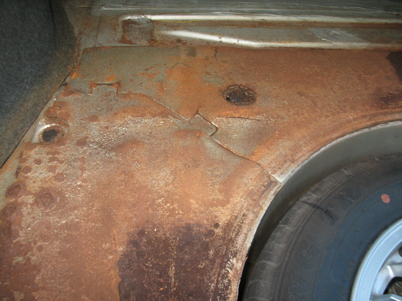

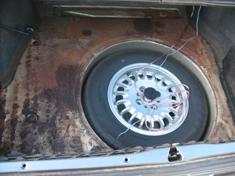

                  Also I pulled the trunk carpet back and saw this .. the rust isn't really much of a surprise, but it doesn't seem to be too bad .. it's still pretty solid .. I guess it would be best to just get those bits cut out and some new pieces welded back in?

                    yup! b27. dude is that rust on the trunk lining(or watever)?
                        Yea it's pretty rusted ... solid, but rusted
                        And it's a B27 huh? Was hoping it was a B25 .. those have a bit more go huh, or does the B27 have potential? I doubt I'm gonna go turbo (I saw that now but ya never know) .. I really just want a nicely built NA motor that has some go .. maybe like 175ish to the wheels would be nice :)

                              I just read that the B27 has a 4500RPM redline where the B25 has a 6200 which is what my tach says ... so maybe it has a swap or something?
