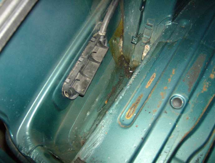

        I think i have this problem.. My sunroof drain is zip tied right under my antenna motor, and just drains onto my floor jack :( Where is this supposed to go? I want to fix my leaks! :)
          The sunroof rear drain pipes (one shown here at the centre top of the photo) connect to the vents passing through the quarter panel covered by the bumper cover.
