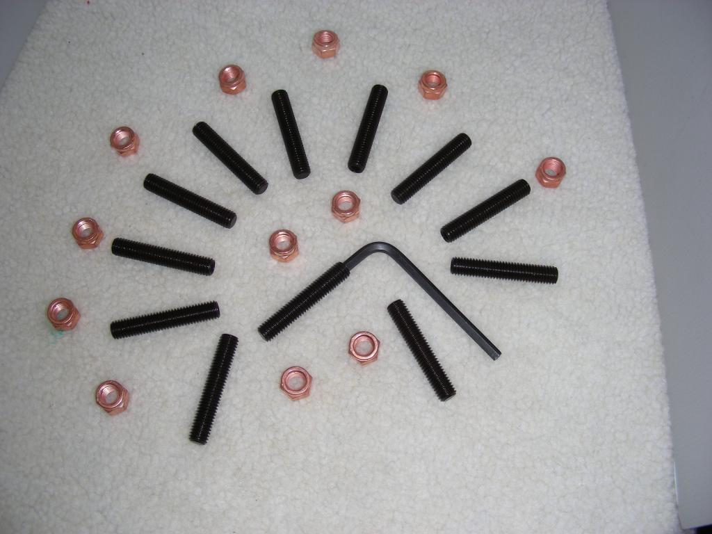

      If its sticking out, i use these
      88 325ic ~~~> Rusty and ugly
      85 E ~~~> RIP
        you sould
        buy these from me...
        bimmerboltsandparts.com
