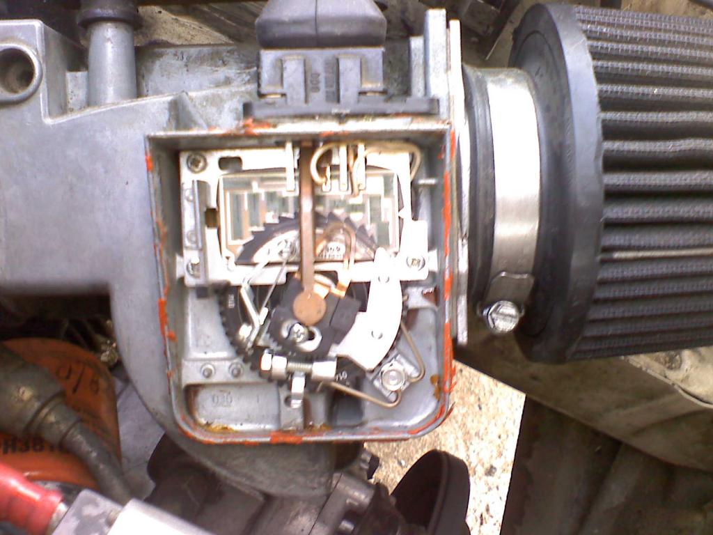

    has anyone ever adjusted the wiper?
    these are my symptoms...
    new 2.5" straight ss exhaust and new header
    84 m10
    1. car idles at 2k
    2. icu is backed all the way out
    3. car runs mad rich
    4. when i push the wiper idle slows down
    (the po opened the black cover leads me to believe it has been tampered with)
    im thinkin if wind the icu in to half way and adjust the wiper i could get a better power band to match the free flow exhaust.
    any thoughts or expriences?

    Some people do this when installing the 027 m30 afm on m20's. I tried it just to see what happens. It can make your car run like a total bag of shit at idle I'll tell you that. Wouldn't recommend it myself. If it has already been fucked with it would be worth trying to get it back to original. Search for the m30 afm swap I can't remember off the top of my head which way to turn the wheel to lean out the mixture.

      Read the whole article but pages 10 and 11 should be of most interest to you.
      IIRC this article says not to adjust the coil return spring, as it is "laser calibrated from the factory' or something.
      But IMHO as long as you mark/scribe where it was initially, play with it as much as you want to get the best out of what you want from your car. Dont expect a whole lot from messing with it as the best thing to do is to get a new/better/re-manufactured one.
        To lean out the mixture you want the door to remain on the more closed side when air is flowing through.
        As the further open the door is, the more fuel is added.

              i have adjusted mine. but what you have there is a "air flow meter" not a mass air flow sensor.
              adjustments. i would only adjust to 5 teeth max either way. start with two and keep going.
              counter clockwise= rich
              clockwise =lean

                you really shouldnt touch it at all. It will not make your car faster.
                your car runs like crap for another reason. find the real fault and fix that rather than adjusting everything in a very crappy non precise way to compensate for other problems.

                    oh yeah i think what they are refering to in that the resistors have been tuned by a laser.. which in 1984 was a BIG deal. lasers cost thousands of dollars then . now they give them away as key chains.
                    i showed the part to the laser guy (who is also our electronic engineer) at my job today and he said he could remake one minus the carbon resistor...
                    badvibes you rock thanks again!!!
                    PCB's (printed circuit boards) are so easy to make these days...i just gota find someone to do the resitor and ill make a new one
                    the article says to carefully bend the wiper to a new portion of the resistor

                              finally got it done
                              the key is tiny tiny adjustments!!!
                              got play with the icv too...
                              but the two together leaned out my mix and gives the car more pull
                              ive got a a/f ratio gage that i made going in next...
                              sum total ...its really not voodoo!!!
