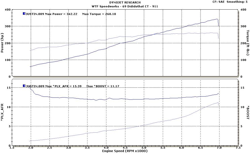

    So I got the E30 retuned today after putting in s50 cams and a 3in exhaust. It put down 343whp and 260tq (Dyno-jet)on a 90+ degree day. I can not thank TRM enough they are awesome guys, if you need anything BMW call them first!
    Quick Specs
    1990 BMW 325I
    M52B28 Stock with S50 cams
    AA C38 stage 2 kit ~10.5psi
    TRM tune
    3in exhaust
    Zf with 3.25 M coupe diff
    Etc...........
    Dyno sheet will be posted soon.

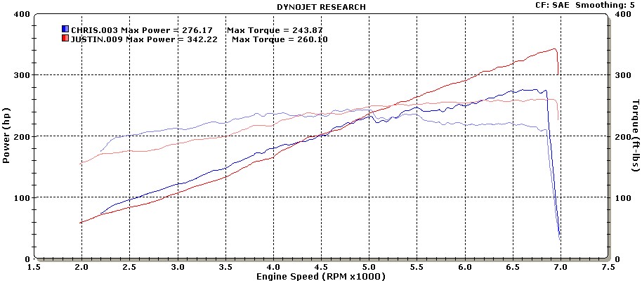

      2nd is the M52 with 11~ psi s50 cams and c38-81 blower
      vs
      s50 with 3.5 maf 24lb injectors custom tune

              That is a beautiful graph!

                That HP curve is straight as an arrow. I'm really thinking I need to SC the m30.

                  keep in mind that the curve is not just the supercharger its also alot in the tune

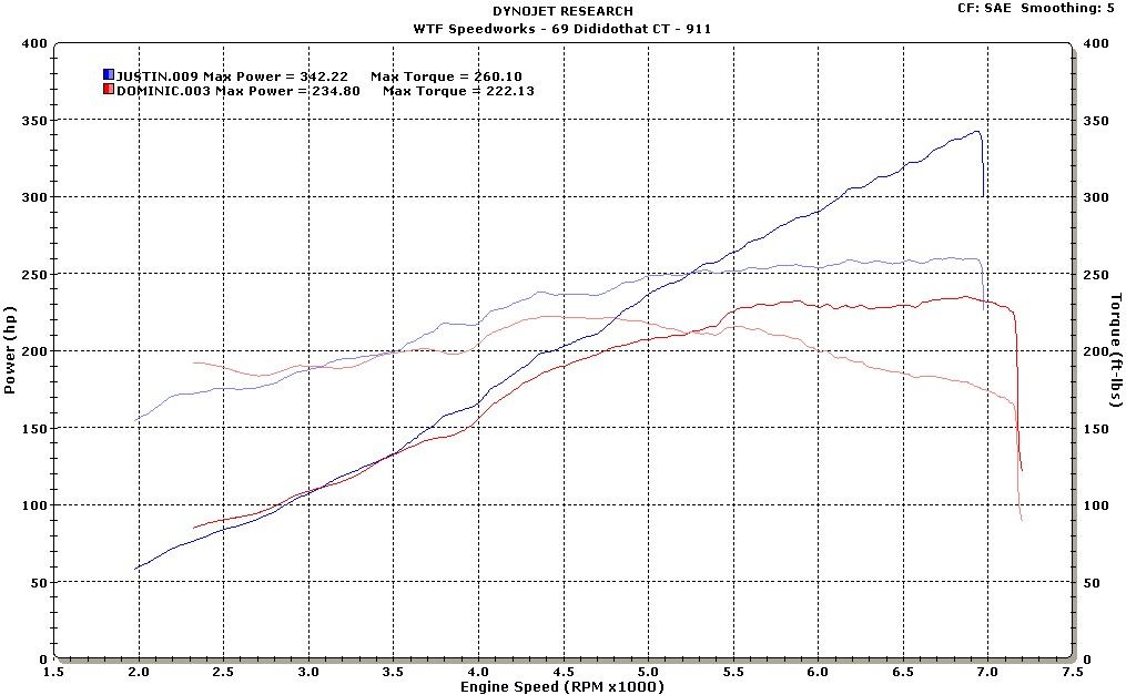

                  here is a comparison
                  stage 1 active c38 M3 obd2 on active autowerke (shit) tune wavy as shit with lots of dips no fun. hopefully the car will be up with trm soon for a custom tune.

                    Holy trap that is garbage and its an s52. TRM really did a great job it all works really well together in my car, I am happy forsure.
