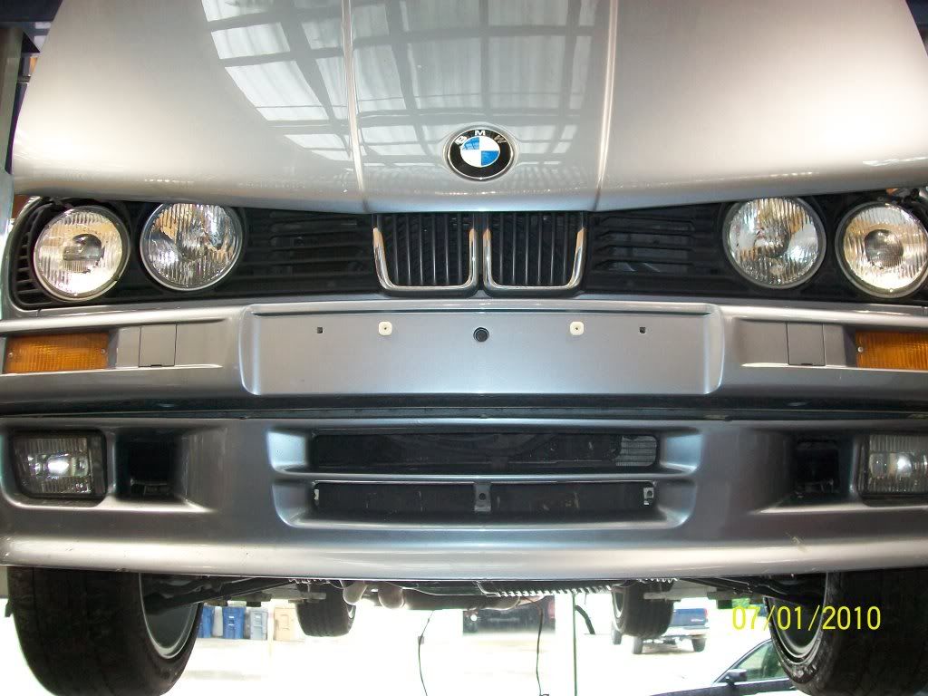

    Here is a pic of her in the garage:

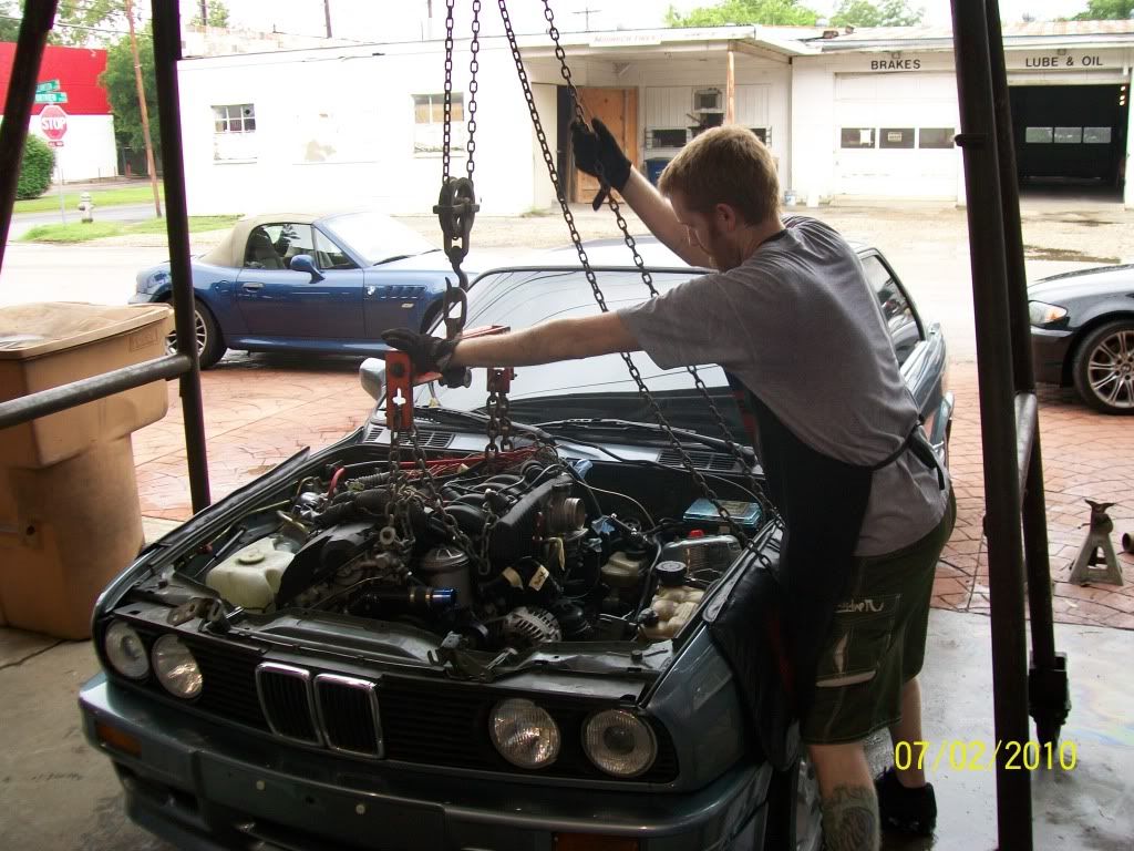

    Here are some pics of the work so far:
    Engine coming out:

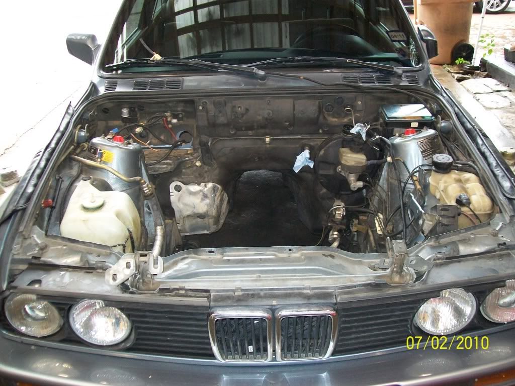

    Ready for the S50B32:
