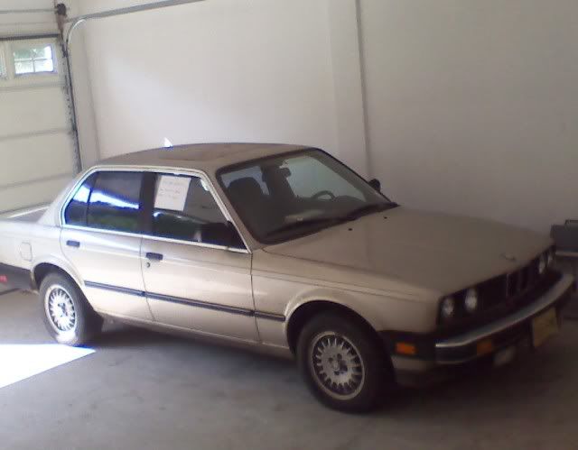

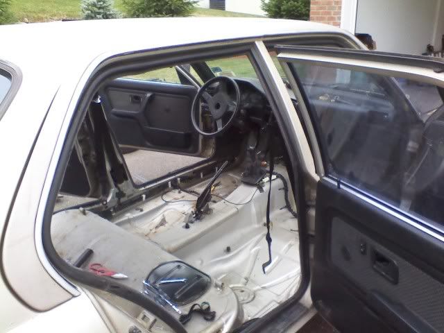

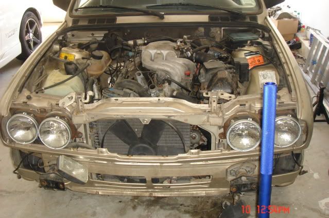

    here are some pics of my hooptie:
    2nd day home:
    Looking for rust:
    Tear down:
