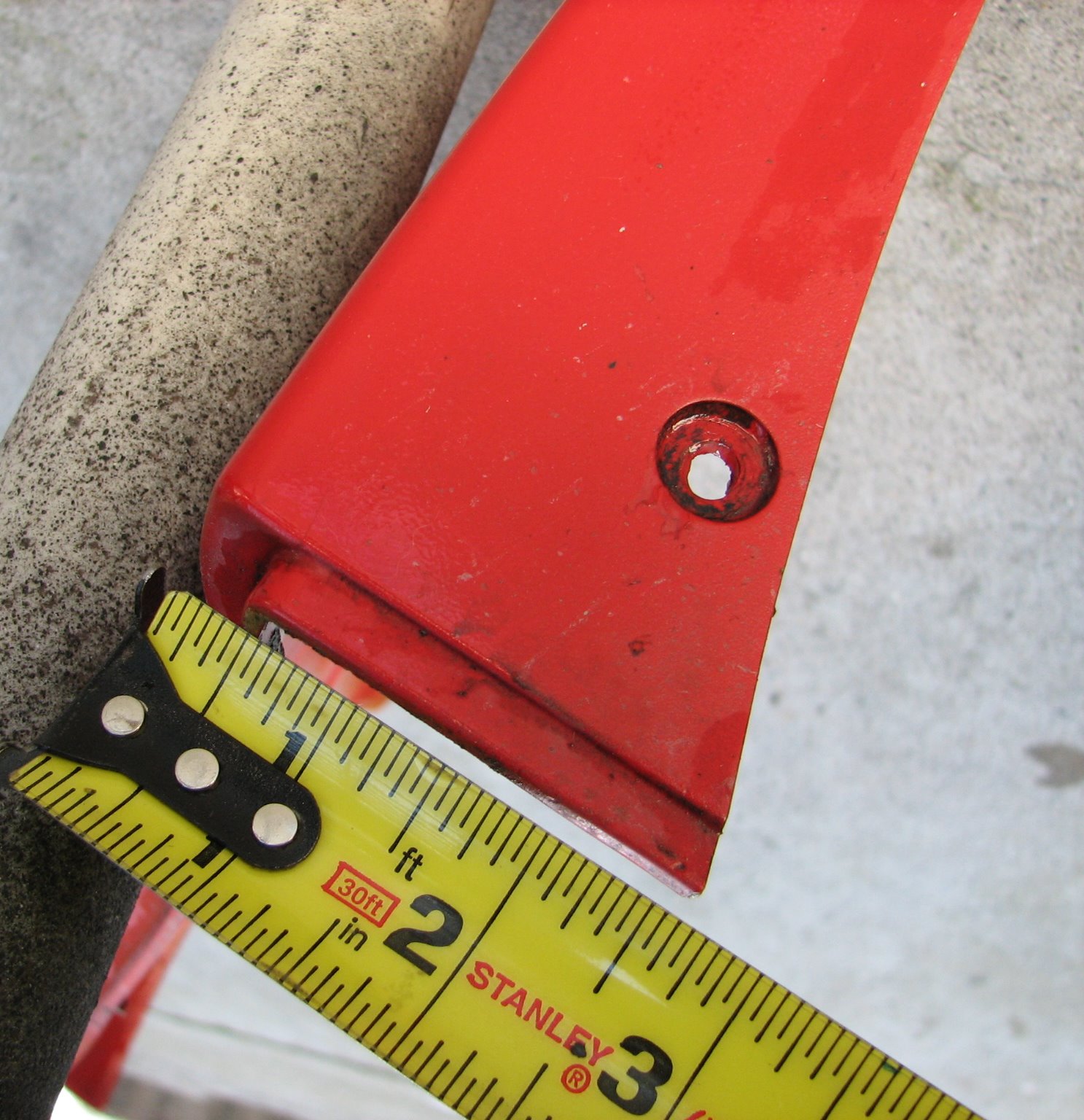

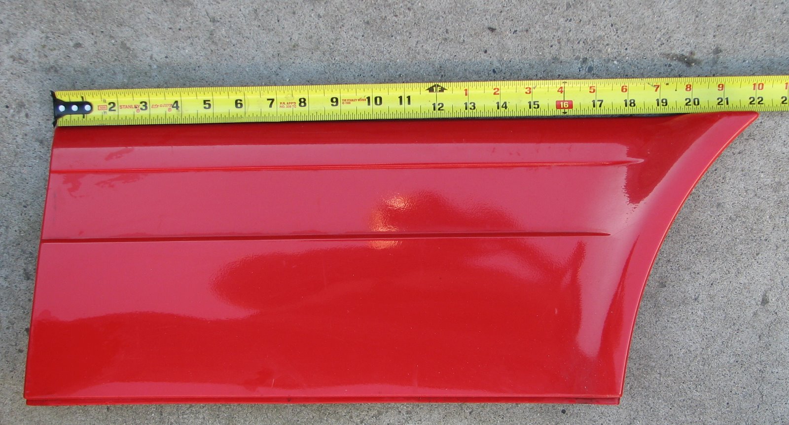

                        here are some pics. if anything i would think the bottom on the panels are wider to accommodate the wider rocker panel.
                        Much wow
                        I hate 4 doors

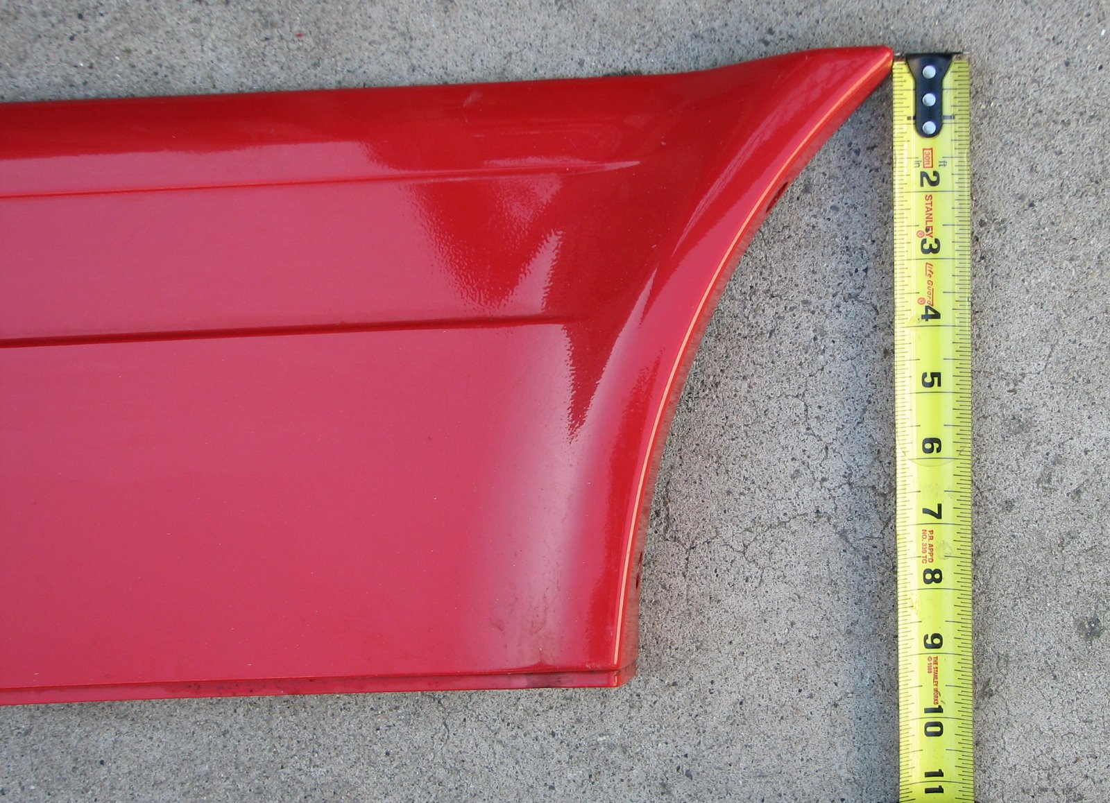

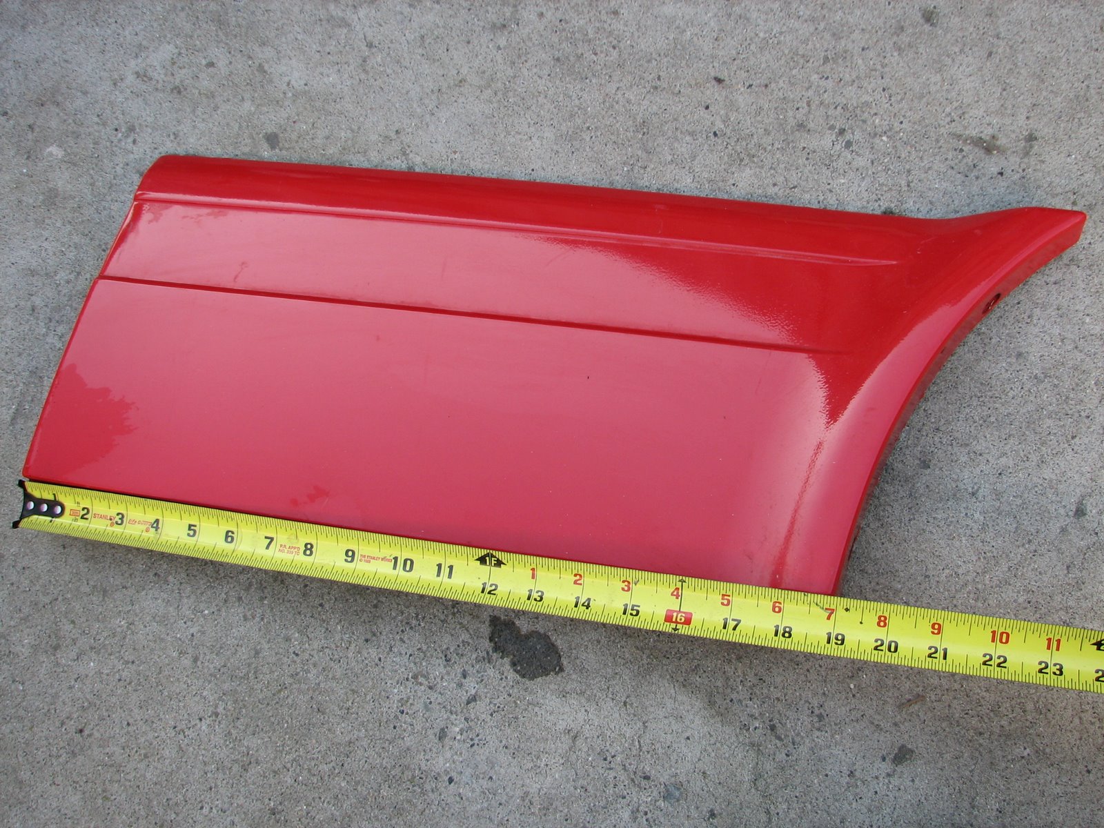

                          Here's pics of a coupe m-tech II left rear panel

                            Thanks for the pics guys. Another difference I just found is the price. The convertible panel costs over 50% more than the coupe part.
                            I don't think that's it, as the front fender pieces and the door pieces are the same between coupe/vert. It's only the quarter panel piece that has different part numbers. If the vert kit was made wider, you would expect the fender/door pieces would be different as well.
