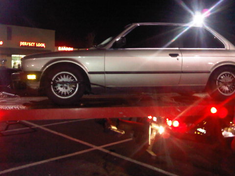

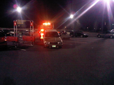

So..no way to get the car to run. (325e). Called a tow truck and...60mm drop front and 40mm drop ...a piece of apper would have barely fit between exhaust and front lip wihtout using some wood to lift the car beign pulled up.
Kind of lucky, I straighten the driveline before locking the wheel, so it was parked straight, however in after-work-busyness food shopping traffic.
Took almost an hour to get the car moved in and out and onto the tow truck.

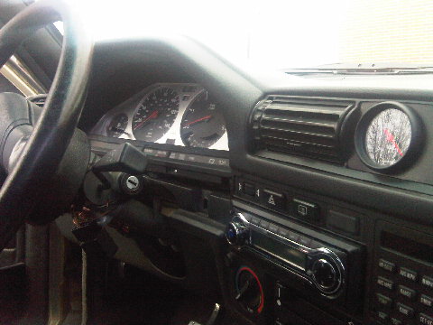

At work then i decided to remove the steerign wheel prior trying the locks function "just in case", whcih was a good idea.
Sodding lock gave in completely.:evil:

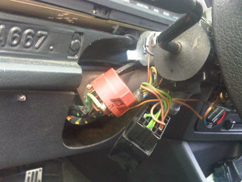

Removed the plastic housing from the steerign column under obseration of my over-curious colleagues, had a closer look and one pin is wedged within the lock. (the second pin)
no matter what i tried, its so not moving. maybe metal shave from the ages combined with a vaporized spring caused that...no idea..no care.
steerign wheel out of the way, i could pull the pin from the steering wheel lock and the ignition switch... and at least am able to start and drive..guaranteed to be pulled over if a law enforcement office is next to me and sees all the loose parts.
Well, now havign everythgin exposed anyways, not sure what to do.
1st, ill try again to remove the lock. else ill drill it out somehow.
