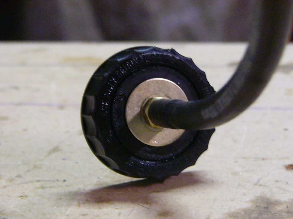

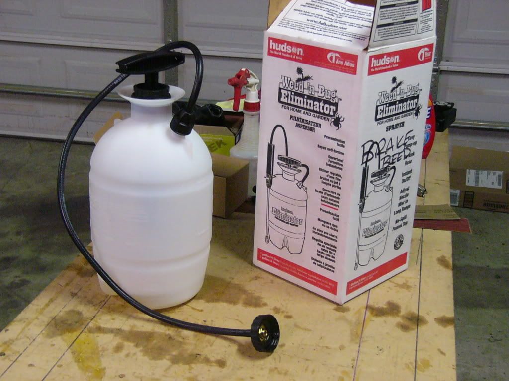

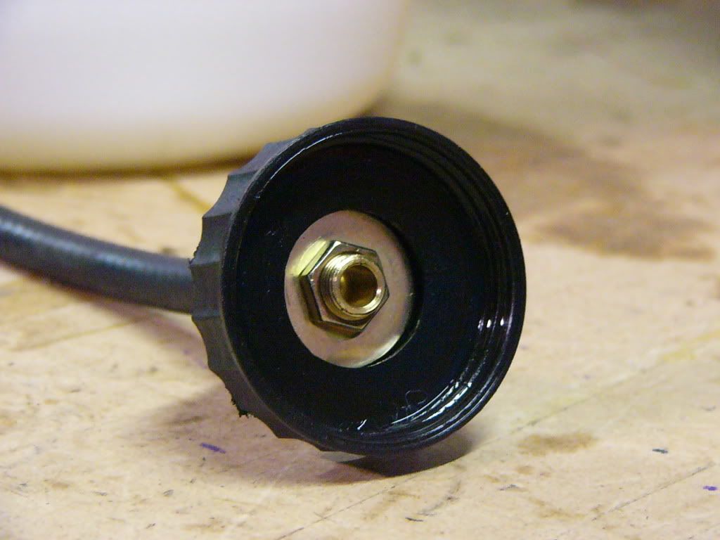

Help! I was bleeding the brakes after putting new bushings in on the rear of the car. The lines had been disconnected. The brakes had air, but now are good. I should say that I started with a pressure bleeder, but went back to the old school way. The pressure was at 10-14 psi.
