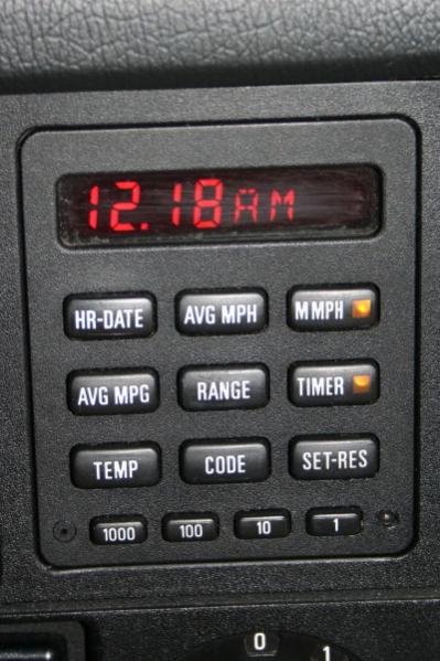

    1st: Can you see MPG on 318is main onboard computer?
    2nd: Can you put this:In a 1991 318is?

    1: you need a 13button obc to view data like that
    2: it would take extensive wiring for it to actually work as intended, but you can make it light up when you press the test button fairly easily, find a switched power source and ground and splice it in.

      here is on how to do the obc if needed...

            Your picture is one thing and post content another. The 318is/i "OBC" is really just your glorified digital clock that can display the date and the outside temp. It also has a time/date/temp memory funtion, that's about it. Here's an actual on board computer with MPG calculation (originally n/a for m42 cars):

              OBC is the thing with the check button that goes in front of the sunroof? how come the 325i has an MPG reading and the 318is doesn't..
              *Edit* On board computer (got it)... still is that the one on the roof?

                N/A but you can make it work "with extensive wiring"? Are you guys talking about the same thing? hehe I'm brain-dead tonight, sorry guys. So what up if I want a freaking MPG reading in my car????

                    You can use any 13 button OBC in your 318is.
                    Refer to this link. http://users.rcn.com/xmon/OBC-Convert.pdf
                    I have installed a 13 button OBC and cruise control in my 318is.
                    It works great.
                          ...check panel? I've never been in a 1991 318is. stupid question on my part but what do you have there instead?

                            We have a stealthy one, all it shows is the srs light and if your seatbelt is unbuckled, it's black if everything is in working condition.
                              Yeah I think the one with the white lines is cooler, the blank one looks out of place IMO. Feels like a missing option if you know what I mean.
                              like when you don't have air con and its just a plastic filler
