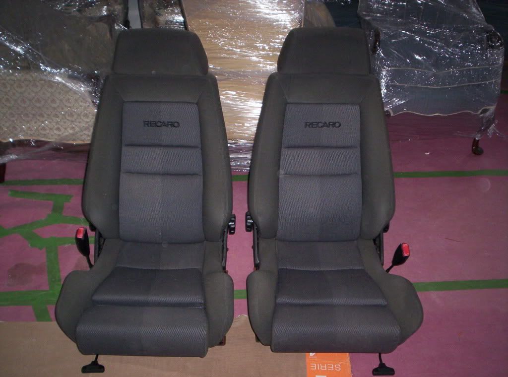

                    I'm not disagreeing with you, but I'm not really seeing the difference between the LS and the LX.

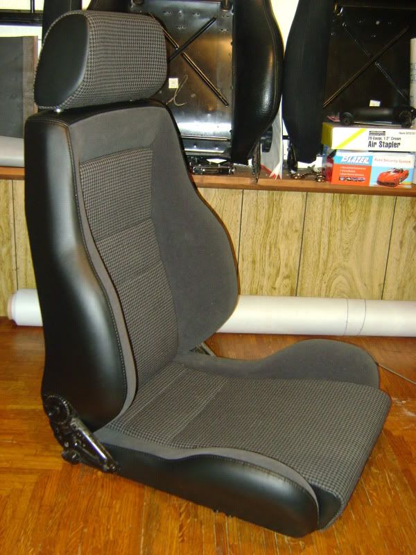

                        The lx has a triangular smaller upper bolster while the ls has a large rolling upper bolster.. Here are two side shots of seats we have recently recovered for comparison.
                        lx
                        ls
