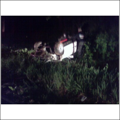

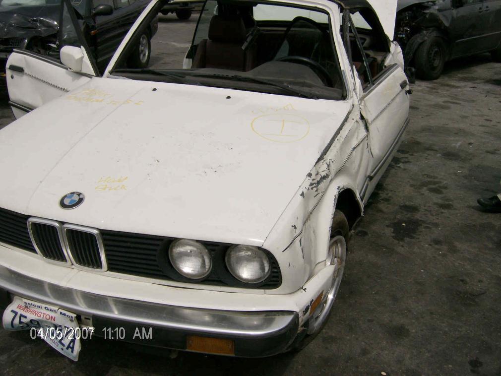

            On that note, here's some relevant pics.
            -Dave
            2003 Lincoln Towncar | 1992 BMW 325iC | 1968 Cadillac Deville
            Need some help figuring out the ETM?

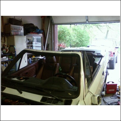

            • DaveSmed
              • Apr 2007
              • 1407
              These aren't mine.
              -Dave

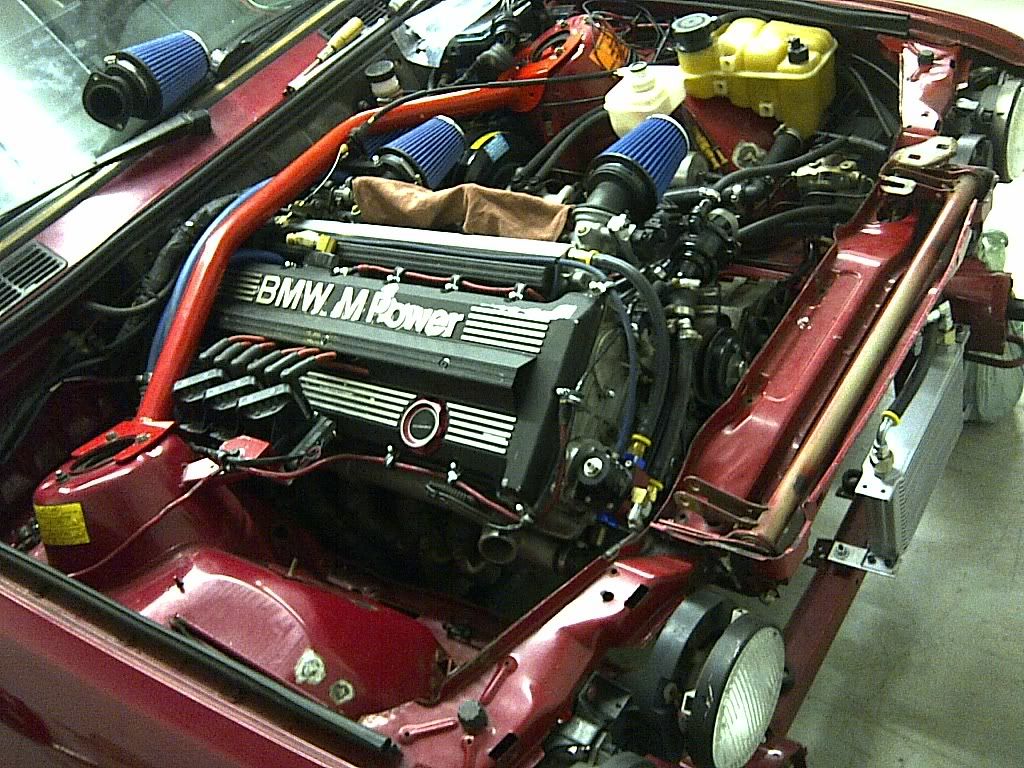

                            Originally posted by TimR
                            Start install next Thurs. The vert. bucket would add stability to this! Whats with the double bars down the windshield??
                            lol um this looks familiar
                            lol even my idle control valve has its own filter

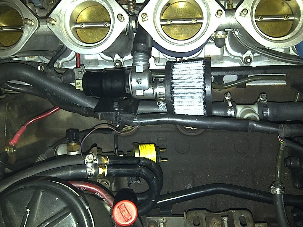

                              • Bimmerman325i
                                • 6854
                                ....wtf do S38 swap pictures have to do with E30 Vert roll bar design threads? I'm lost. S38s are awesome....but I just don't see the point.
