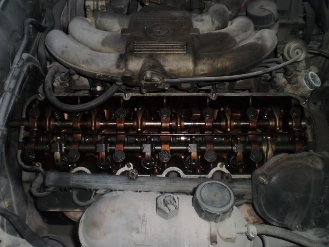

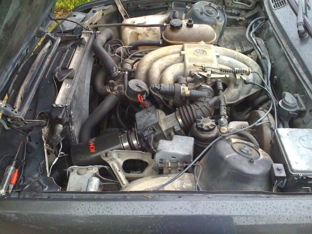

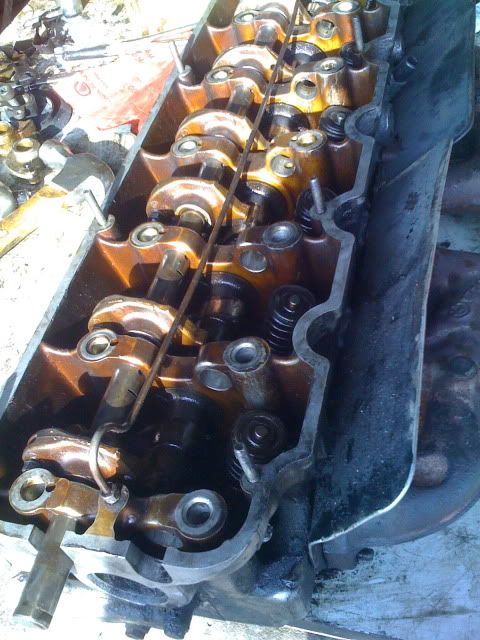

    87 325is
    Can you tell from the pics?
    Before head work
    During head work

    No you have a "i" engine

      The super ETA was in 1988 cars and the DME would be a 0 261 200 154, but as mentioned you have a regular eta.

        It is not an eta at all. It is an M20B25, or a standard "i" engine...

          Looks like an "i" to me--check to see if it has dual valve springs or single.

            Definitely an 'i' intake manifold at least...

              so if I have what looks like the exact same manifold on my eta, does that mean my car's PO was such a fuck up after all?

                The I manifold is more round then the Eta manifold. If your Eta has the same manifold, it doesn't mean the last guy was a fuck up. It's a pretty popular modification to put an I manifold on an Eta engine.

                    you have an m20b25 i engine

                      Id atleast has a I head on it. Look at the cam journals

                        ^ You've already answered your own question. NO, you do not have a SETA engine. You have a standard "i" engine, nothing more.
                        SETA engines only came in the '88 325es or '88 528e.

                              I've done this on both of my eta engines in the past, and combined with a 325i throttle body, (and if you're really ambitious, port-match the head to the intake inlets), it makes for a very nice intake upgrade.
